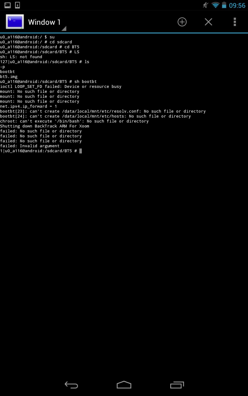

When I try to boot it I get these errors, and I'm not sure what I'm doing wrong. I know it says BackTrack ARM for Xoom but its modified to work on all,

Bad news, they knew how to do it right.
They check to see if the loop device target exists (in use) before proceeding and give an error message if that happens. So they don't assume a free slot, in other words.
That passes and they use the shorter command sequence and handle it through a mount -o call. So while they don't do an explicit losetup, they don't need to, it's kernel limited as you thought.
I guess maybe your next move would be to ask kernel devs working this device to add the feature for you.
