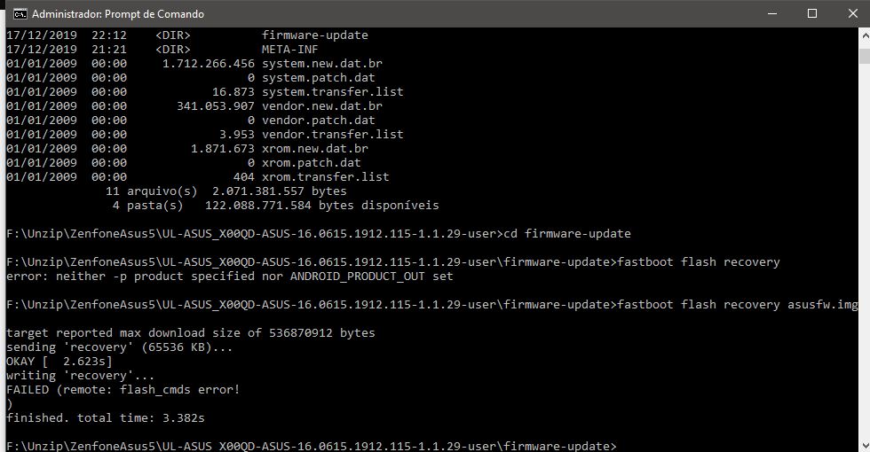

I followed your tips, but no results. Would please see the attachement?
Is your bootloader unlocked? You won't be able to fastboot flash much without that.
Also your last attempt you tried "fastboot flash recovery", but it looked like it was sending a 64MB file - which seems rather big for a recovery image. What exactly is the file you are trying to flash (I don't know Asus devices, but if you are trying to flash it I assume you know exactly what it is). @ocnbrze's link was to a 2GB full device firmware, which is much bigger than this seems to have been, so it would be helpful if you told us exactly what you are doing (and, as asked earlier, how you got into this state in the first place).
Well. I can't say anything about this phone since I do not have access to its caracteristics.. The things I know: (1) It had original SW on it; (2) I tried to root with Kingo Root. After that infinite loop has begun. I can't take it from this diabolic situation. Unfortunately I do not have much knowledge about cell phones even being an engineer (?) . I use it as I do with my tooth brush... I keep trying to find a solution, but yours experience is fundamental to me. Please
So almost certainly the bootloader is locked. I don't know this model so don't know whether it's possible to unlock it without having access to the operating system.
But official firmware usually does not require an unlocked bootloader to flash it (indeed sometimes requires that the bootloader is locked), so you should be OK with that. So maybe tell us exactly what firmware you have downloaded (because the size doesn't match the full firmware that @ocnbrze linked)? And also where you found the instructions to use "fastboot flash recovery" to flash it, because while I don't know Asus flashing I do know that that isn't what the instructions he posted say (and that that command is only for flashing the recovery module, nothing else). Did you attempt to follow the instructions @ocnbrze posted? The first 3 steps in the xda post look like they'd do for flashing the firmware to me.

These are the instructions I followed
Except, as I said, the file you are flashing is small to be the one from the first link (but too big to be a recovery) and the command you have shown us you are using is not in the instructions in the second. So that doesn't tell me what you have done.
What matters is what you actually did rather than links where I don't know how you have interpreted them and which parts you have followed.
I suggest looking for your specific model and provider for the correct firmware. Handron is correct, the firmware your flashing doesn't match. I'm guessing the procedure is the same, its just the wrong firmware. If you plan on installing a custom recover that also is device specific but that comes later. I recommend reading threw the XDA threads and get familiar with your device. Some firmwares prevent downgrade. The safes way to avoid incomparably is to upgread to the latest firmware for you specific device and carrier but sometimes the most recent firmware is unrootable and/or prevents downgrade. For instance My Note 4 is on the latest firmware a fused 5, binary 4. It prevents me from downgrading back to lollipop roms. If I were to flash any other official firmware for my device I would wind up in a bootloop (Samsung Odin sw rev check fail) The last firmware will be your best chance of recovering from a soft brick.
I'll give up. After my last try
ZenFone5_UL-ASUS_X00QD-ASUS-15.0616.1803.8-1.1.13-user.zip
I see the window of options (reboot, recover, etc), but nothing hapens. I really think that my cel phone is broken. We can stop this tread
