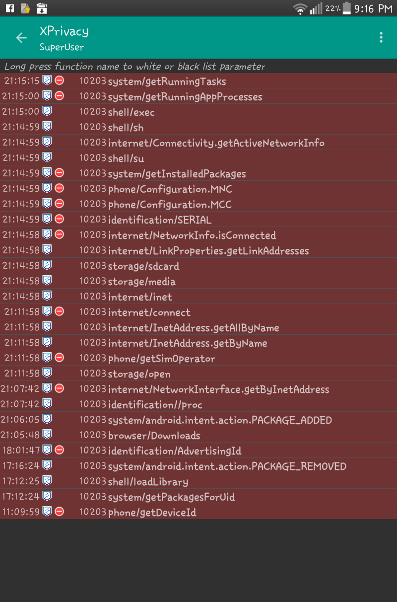

King0root is not any better!!!!!! It was attempting daily to send device info to a server.
King0. SU
Wanted the following device info and was caught trying to then access a internet connection to send the info to a server...... It also wanted the following...... device serial number and the device ID, the Sim operator(your carrier for data/4g services!the contents of my downloads folders and browser history. Access to storage/SD card and storage/media.
This is not needed at all for the SU operations! Only explanation is it's sending that data to their servers!:mad: You can view the proof in the screen shot!
