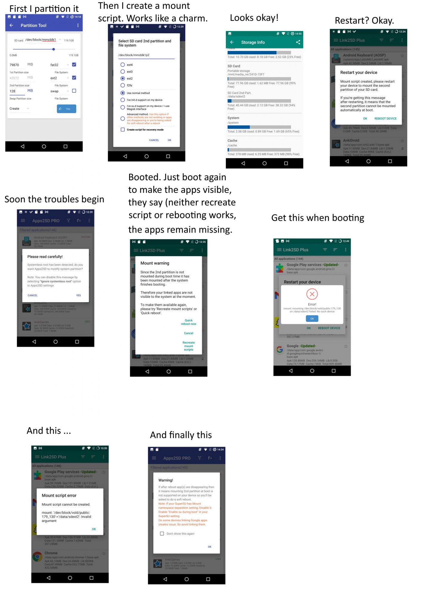

Spot on, I think. The Lollipop supported Link2SD. On Lollipop it took some extra seconds for the icons to appear on boot, but after those seconds, everything worked. But now? Alas! I tried both Link2SD and then Apps2SD, and this is how it goes:
Does it rely on init.d scripts, and do these ROMs support that? If the answers are "yes" and "no" respectively then the question is whether you can add init.d support to them.
When I create a mounting script I am asked about init.d. support on my device. I found a folder called init.d. in my system files, so I assumed yes. I tried creating mounting scripts by clicking on "normal", and also by clicking on "init.d. support", but it makes no difference. I am also asked whether I'd like to create a mounting script with Magisk, but I know I don't have that.

A quick web search reveals that init.d support was dropped in CM12, so if these apps are using that (and I know Link2SD used to) that could explain it.
There are various recipes out there for enabling/adding init script support, but I've no experience with them (I've not used init scripts with anything later than Android 5) so can't recommend a particular approach.
Thanks a million, Hadron. I'm no wealthy guy, but if there's a way to put tip in your jar I'd gladly do it. Now I know where to look. Getting init.d, or perhaps "Magisk" I would guess, even though I know nothing of it.
