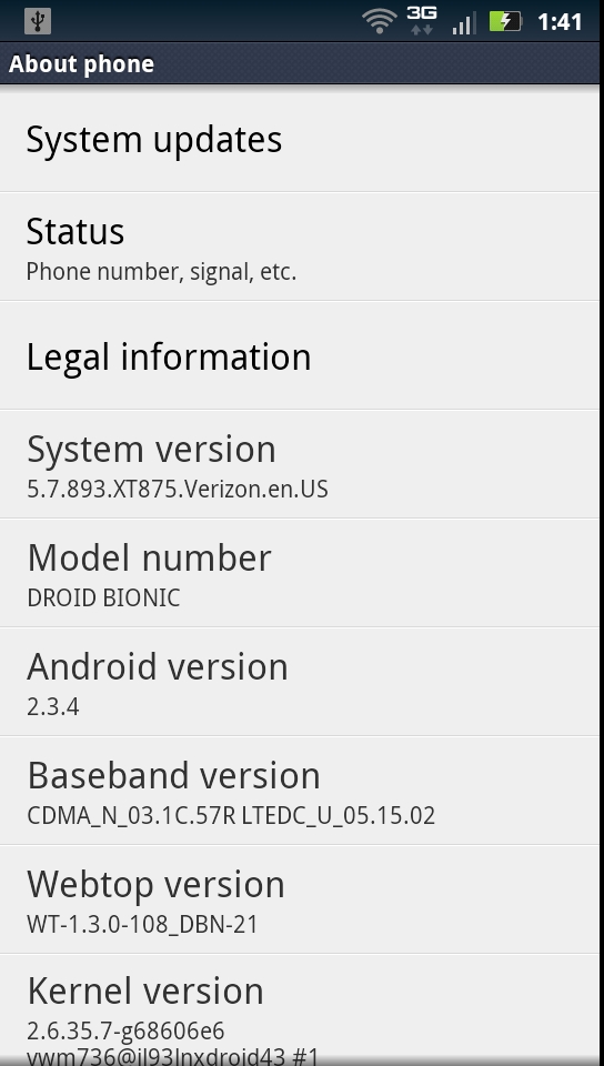

And this is my new 5.7.893 system WITH Webtop:
Just went through it. That was a journey for me coming from D3blurr.
