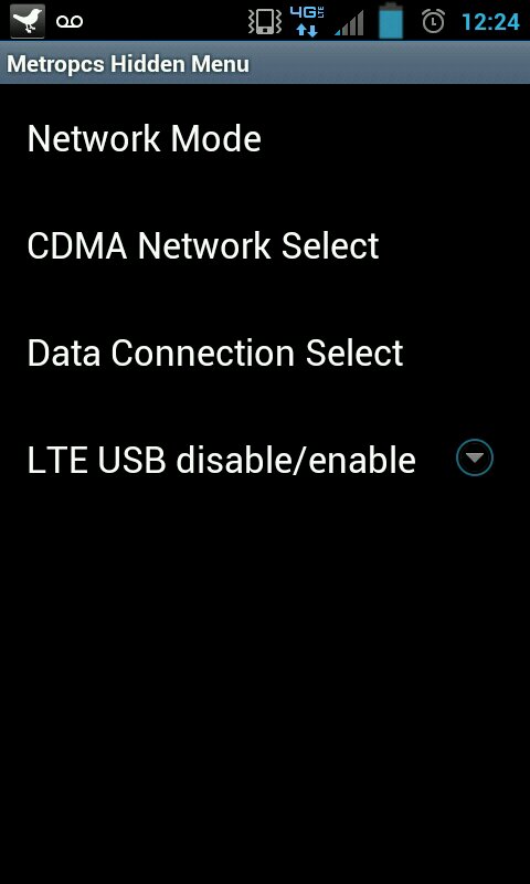

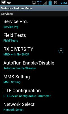

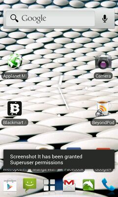

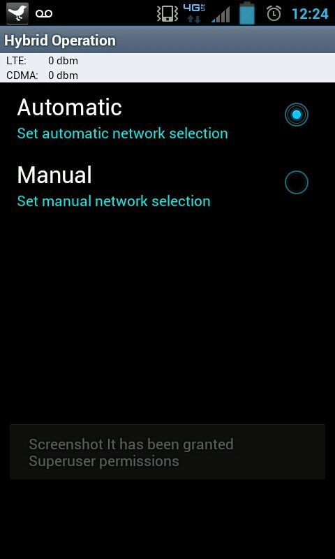

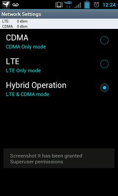

Get anycut from market. Go to new shortcut. Try to find metro PC's hidden menue. Make shortcut. Go to home screen Once there choose metro PC's hidden menue. Once there go to network select/network mode/hybrid. Choose automatic. The phone will reboot with 4g. Pm for help. Had same problem on LG esteem. That should fix it. Screen grabs soon to follow.
This screen grabs will help.

I did what you said and my setting are set to (CDMA + LTE EVDO AUTO)
I still only have 1x. but thanks for trying to help
