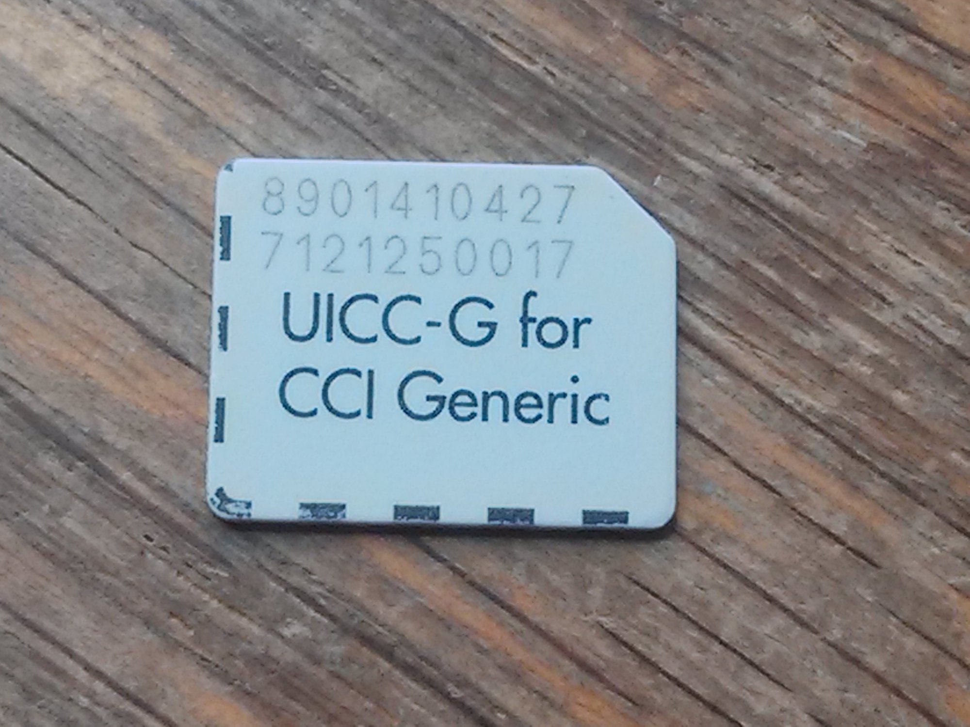

I set my APN per instructions you offered at here , activated that APN, rebooted the phone, and tried again. I'm afraid nothing changed.
I also verified that my SIM card is ATT-compatible using the instructions at https://www.att.com/esupport/article.html#!/wireless/KM1062165. For what it's worth, a photo of my SIM is attached.
I have disabled "WiFi calling" on this phone because when I enable it I get "Error 05 Invalid SIM", and the web forum advice I get is to just disable it. I don't know if this has any bearing on the messaging problem.
So if you can do "a look further", that would be great!

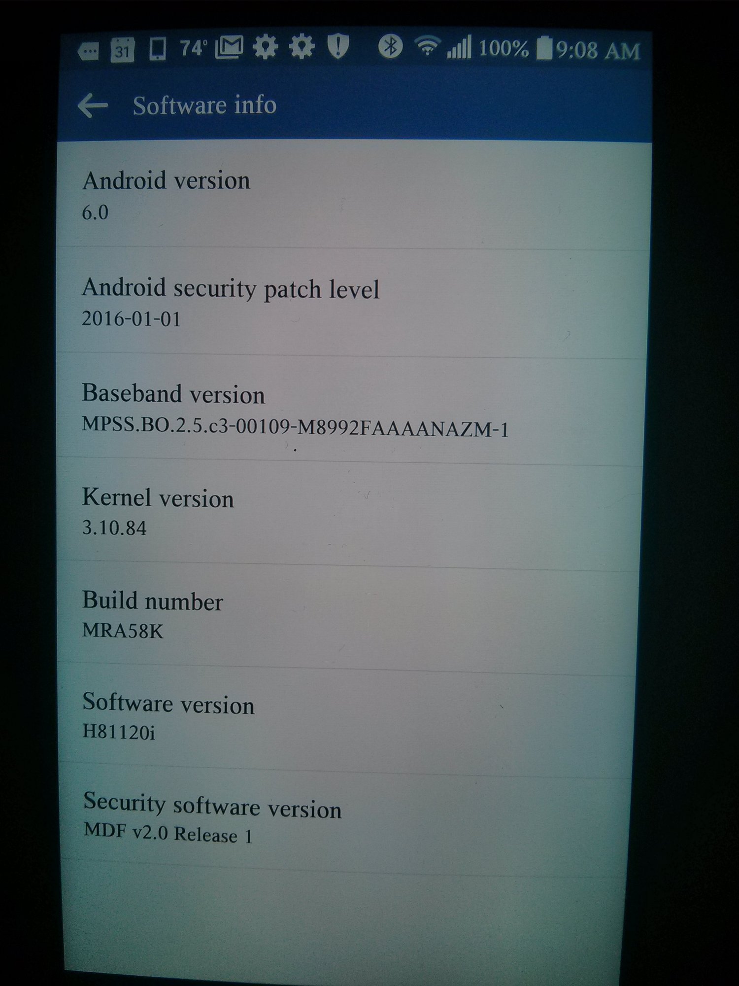

Here (attached) is a photo of my software info, in hopes that it will contain some useful clue. I'm inferring that the answer to your version question is 20i. Thanks again for sticking with me on this...

Update: I tried upgrading my phone from version 20i to version 20o (that last character is a letter "o" not a zero). Upgrade went fine but problem not fixed.
