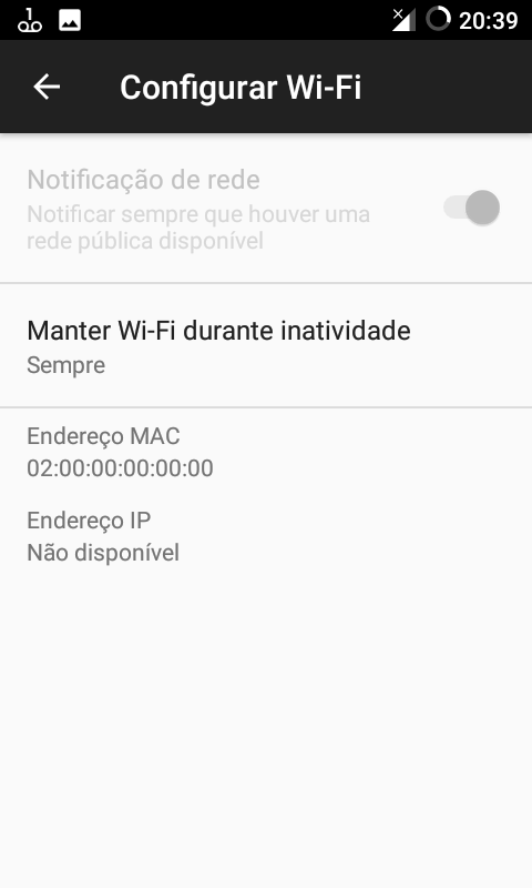

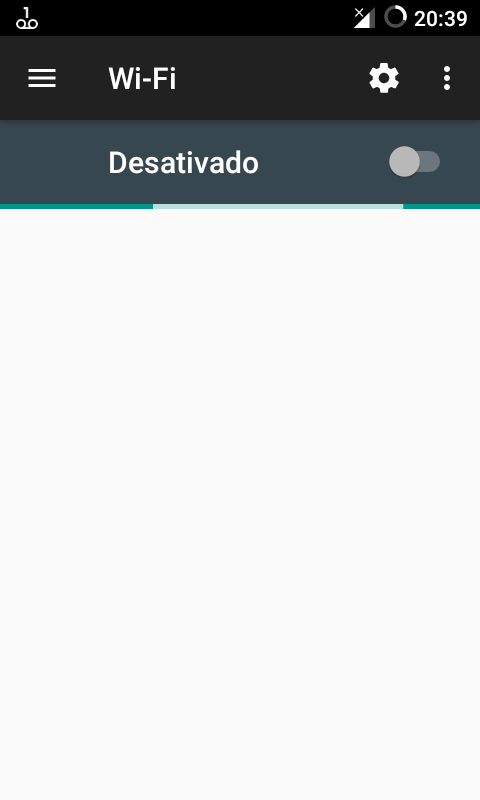

Wi-Fi stopped working out of nothing, even I warning it turns off automatically. Someone more with this problem? I was using this lineage-14.1-20170922-nightly-w5-signed.zip

Wi-Fi stopped working out of nothing, even I warning it turns off automatically. Someone more with this problem? I was using this lineage-14.1-20171002-nightly-w5-signed.zip
what model you have becouse i have d320 and i never had problems with wifi i update every week, i only have problems with lineage-14.1-20170922 didnt want to install i try 3 times and back on lineage-14.1-20170915
