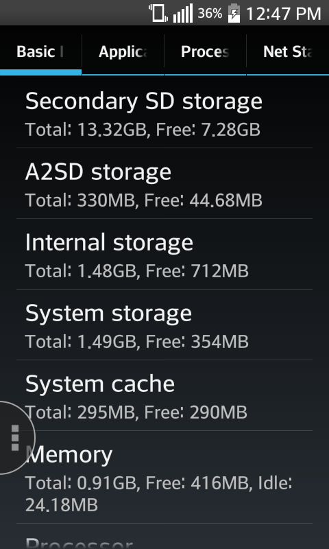

and i got 414mb free with about 54.13mb idle on startup with everything linked mostly but the daily apps. apps i will use periodically i will unlink before use if it is a major issue
