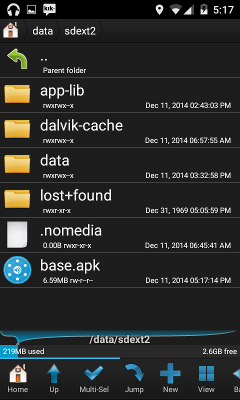

I can't get link2sd to link any apps without them disappearing (or even open after linking to sdext [ext4]) on reboot, also link2sd plus force close link2sd
I kinda found out why, I just don't know how to bypass it

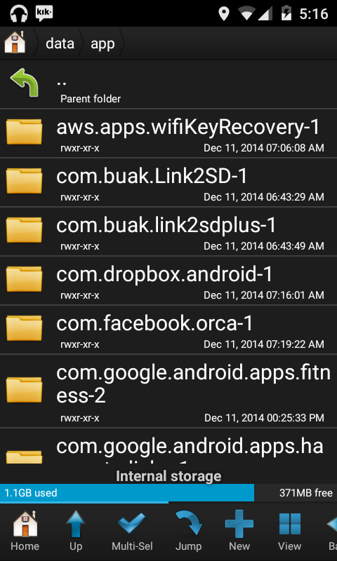

I noticed in 5.0 all user apps are installed in individual folders with the name base.apk (I assume because of ART?)
Link2sd doesn't link them in individual folders, so they are just placed in /data/sdext2/base.apk, so when linking multiple apps, they're just replacing each other
