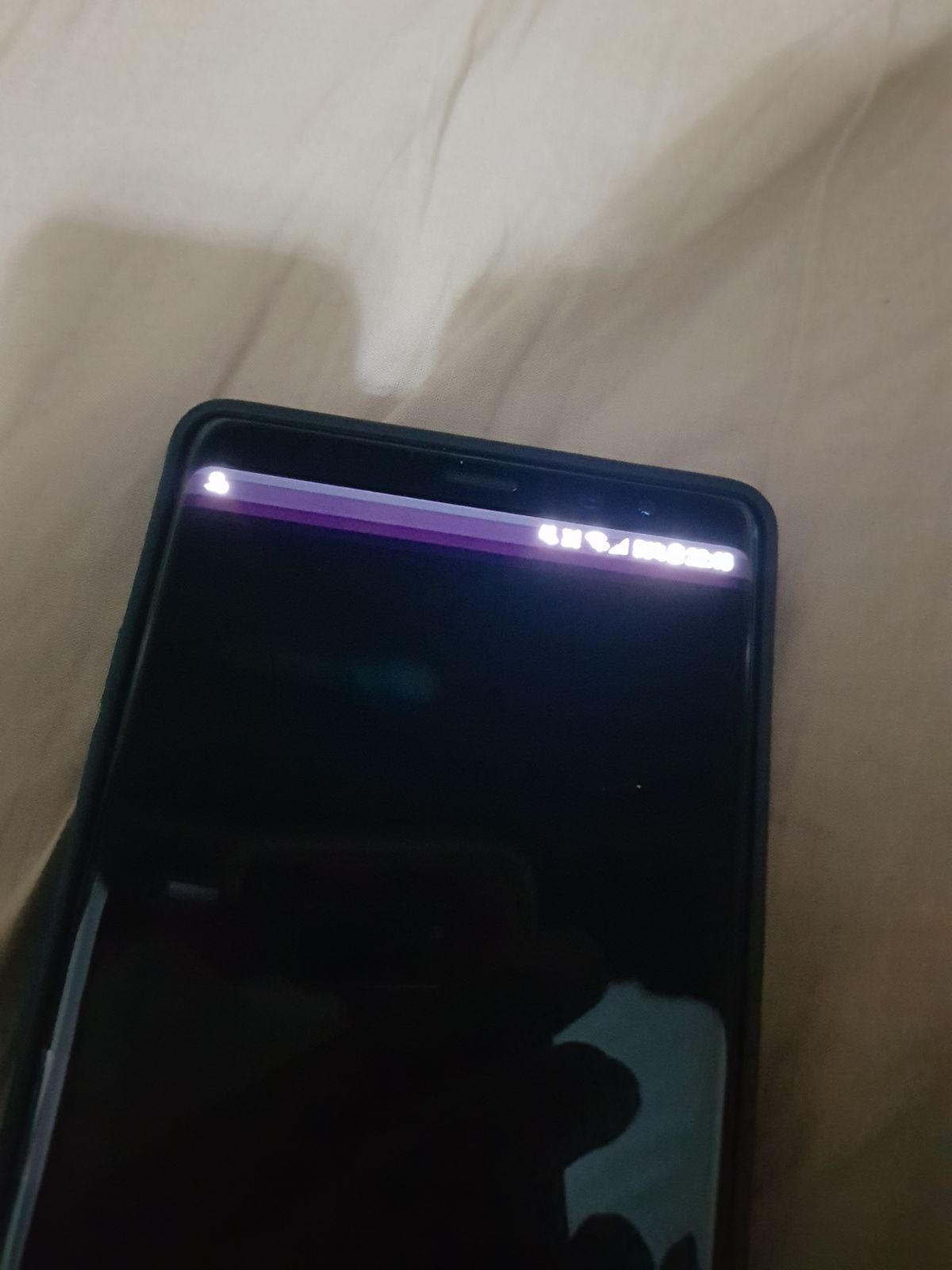

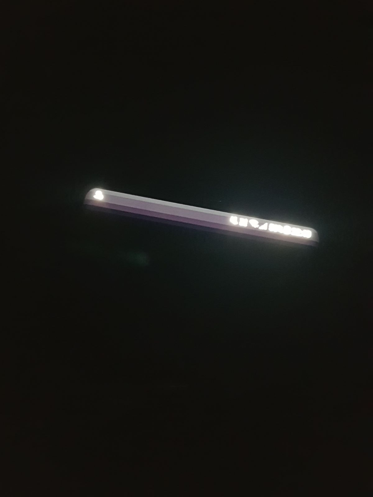

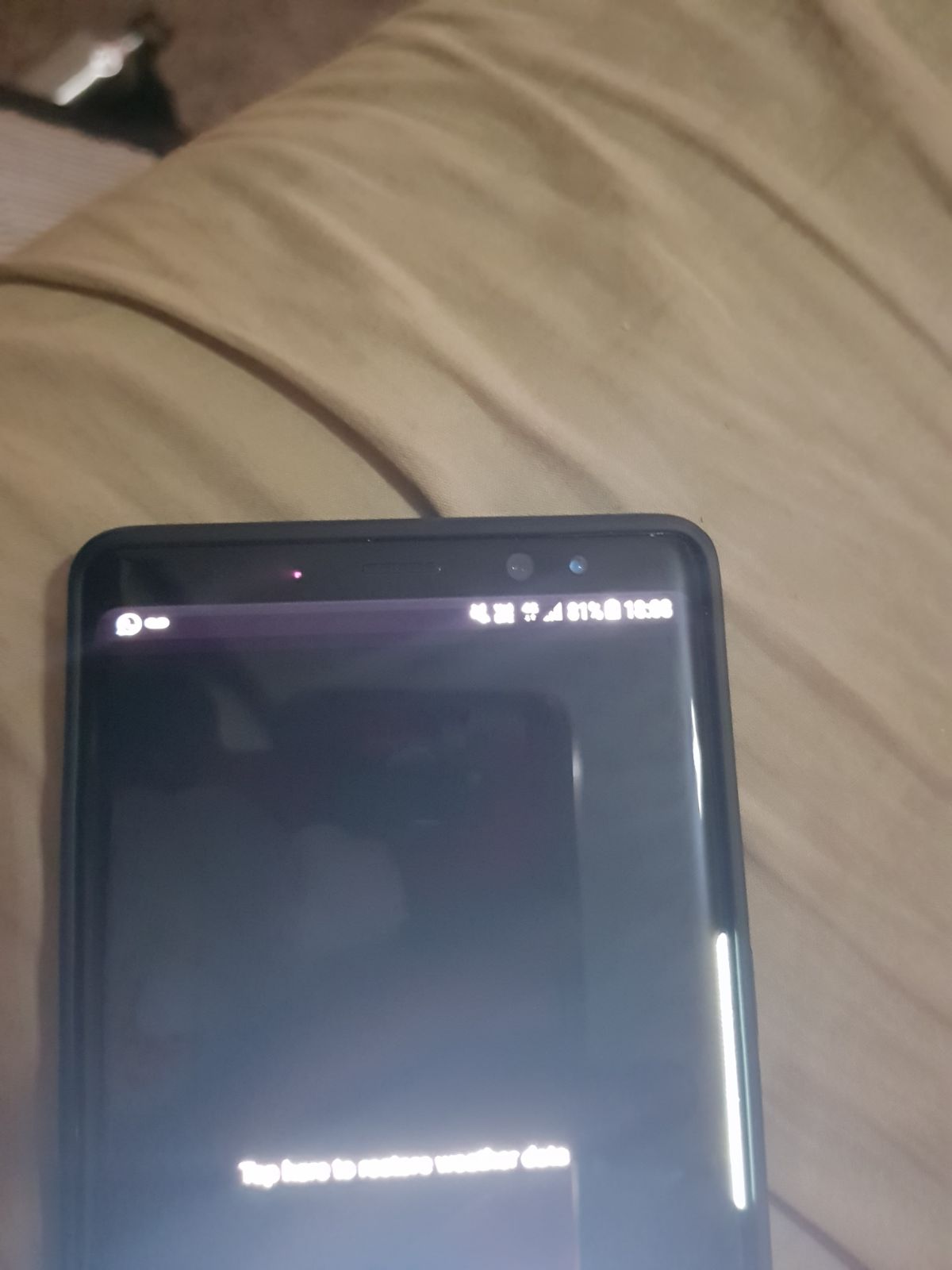

Hi people,
Can anyone help me, I'm going crazy!
Right I have a note 8 a few weeks old. Never been dropped etc. I put a black background(no pictures etc, just pure black) on my home screen. When I turn my screen brightness up to full, and look at my screen in the dark, the top of the screen looks faded(Browny yellow instead of black). I sent it in to samsung and they said there isn't a problem, but their obviously is! Could anyone please try this on their device for me please? Just put 'black image' into Google images and you will find loads of black images to try it with. Thanks in advance (has to be viewed in a dark room, because it's not noticeable in light and the screen brightness has to be full). Thanks in advance.
Here are a few pics.
Just for argument's sake, why not try another launcher like Nova that puts no background in the notification bar. I'm guessing what you are seeing is that TouchWiz defines 'black' as something more than just turning off all pixels.
