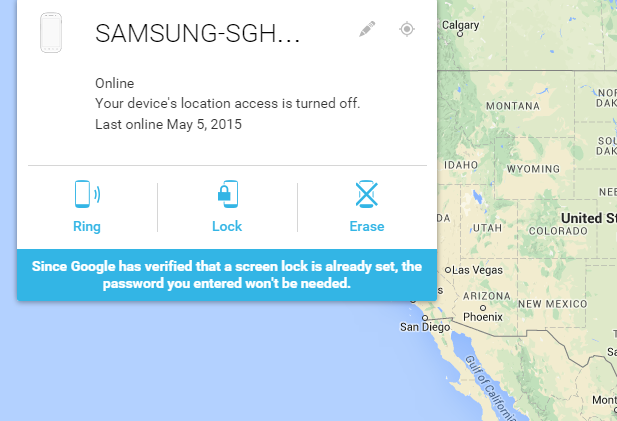

This is the boyfriend. I did exactly as she posted under my phone. I took no special steps. I just put three characters and it accepted it for reasons I don't understand. When I go to the computer I get the message that a password can not be less than 4 characters, but I do not get that message on my note 4 ADM app.
If I use ADM to try to change the password from my device, I get the message now "Lock requested.....Could not lock" but the message will change
I did not use findmymobile.com, but I will try it.
The original message I used was "YOU ARE POO NOW" so that popped up when you opened the screen. Now I changed it and the password to "numbers" and "12345" respectively. Now the message says numbers, but the password does not work. And the result is the same on either note 4 or desktop.
She never activated a samsung account on her device, so that idea is out unless there is a way to do it while it's locked.
Here is what it looks like from the desktop
But now her phone says "the password is "android" but again, android does not unlock the phone
I'm not 100% sure about the registration process, I don't use a Samsung.
Can you get to the emergency call button, open the phone that way, attempt to register from the pc, and complete the registration if it involves Samsung sending a notification to the phone?
It seems like the registration process has to happen by adding the account to the device like you would add an email, and then clicking a button that grants samsung special permissions. I don't think there is any way to do it while it is locked.
