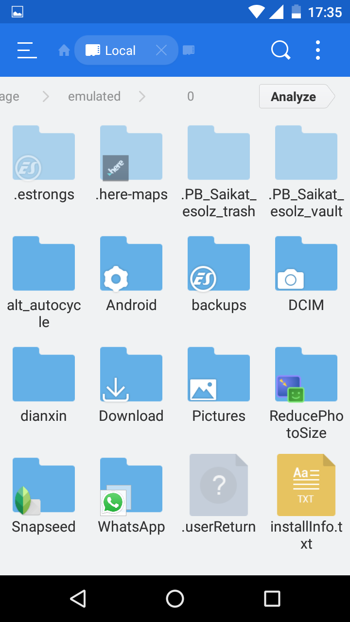

Using file explorer I can see there are only 16 folders and I have been through each and found nothing of any great size (talking a few mb in some)
It would seem not all files/folders are being shown but I would like to get to the bottom of the problem before internal memory gets to zero!

Thanks Hadron, I have ES set to show hidden files and it will only show 16 folders and looking at the properties of each there is nothing of any great consequence.

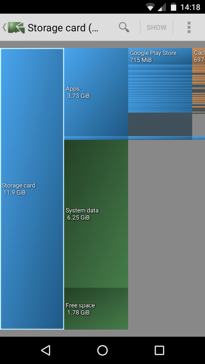

I installed Disk usage which shows 6gb as system?
All getting a bit confusing!
It's showing 6GB as "System ...something". Can you zoom it (pinch gestures work) to see what the second word is?
Though looking at my own, the second word is probably "data". That's actually rather a lot for system data (my phone only has 773MB in that box). The trouble is that without root you won't be able to see what that is. My guess is app data (internal) or updates to system apps, but it's only a guess.
Sorry about that! Yes, system data. Why not show up in ES? Is there a better file manager?
Am I heading for a reset?! Rather not.
It won't show up because you'd need root to see it. Even then I'm not 100% sure what to look for - the label isn't exactly transparent, and if I look at mine with root DiskUsage labels things differently in different views of the same space. It may not even appear in /sdcard through any file viewer (I've had a look through mine with a different root-capable browser and can't see the things I'd think it might be under the /sdcard area, so it could just be a quirk that DiskUsage shows it there).

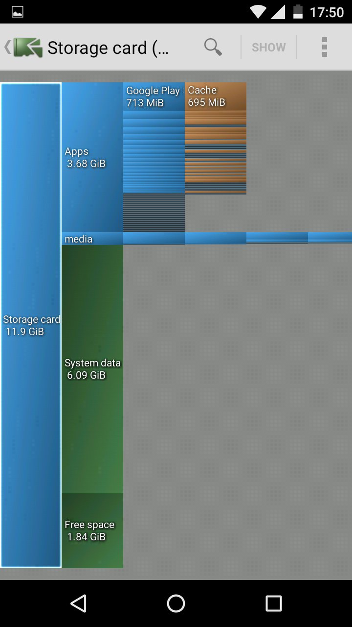

As you can see 6gb has grown, groan!
Ah, so that's 6GB of "system data", not 6GB of contacts.
You can see the size of contacts storage by going to Settings, Apps, All and selecting the Contacts Storage app. Then see how much data it is using. But I doubt it will be the main cause
