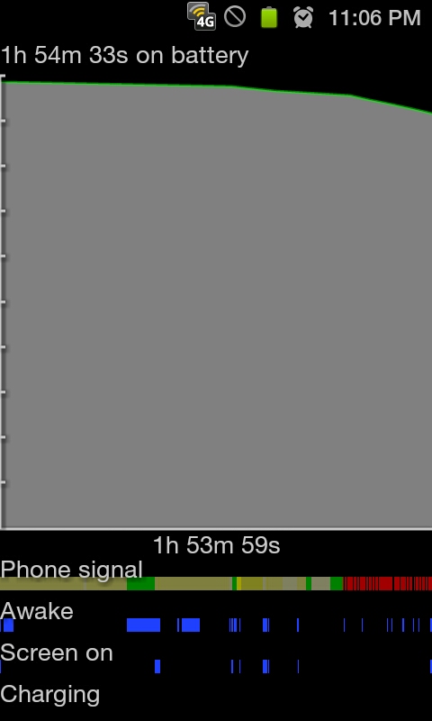

Yep I caught the virus also didn't even notice for about a half hour car ride on the same express wayI use all the time! Not kool I missed a few calls & text mesgs. I tried turning the 3g radio on/off but was unable to regain service without a reboot. Signal was dead to the world! Funny thing is the 4G radio was active & responsive! Not so funny part was my batt. Drained about 7% during this fiasco....
