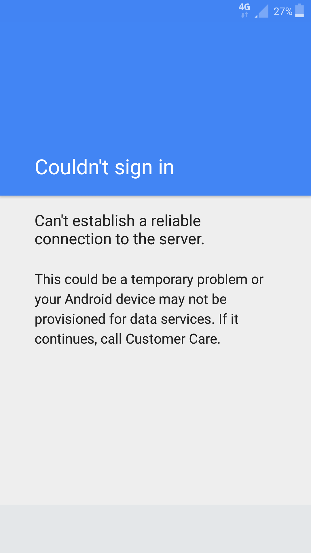

I did the restore steps you suggested but the same problem is still there. When i put my google email in to create the personalisation on my device this comes up.
Since you factory reset the device, check in Settings to see if the date is correct. Sometimes a incorrect date will prevent connecting to Google and the Play Store.
