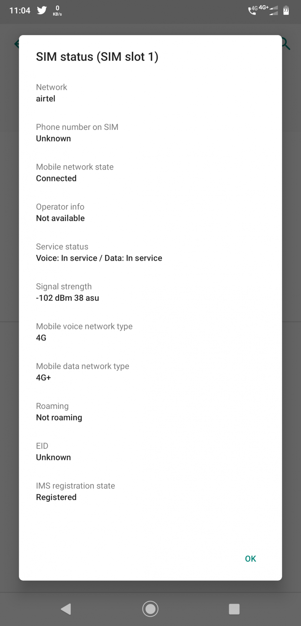

Hi hadron.....
See my signal level is so much low...can Motorola fix with an update...?

LTE signal levels are commonly much lower than 2G/3G. That's why the mapping between dBm and ASU is different. What you show there is a perfectly usable 4G signal.
So, do you have problems with loss of signal? Low data rates? If not why do you think you have a problem? Signal bars are worth very little: there's no standard for what they mean, and more than one manufacturer has "fixed" reported signal problems by changing how the bars look without doing anything to reception at all. I can tell you that my phone (Pixel 2) shows 3 bars on LTE at received signal levels (dBm) that would show 2 bars at best for 3G - it may be that Moto haven't made the calibration of the bars different for 4g and nothing more.
If that's what concerns you then yes, Moto can fix that with a firmware update. They might even be able to improve reception with an update (sometimes happens, rarely dramatic). But nobody can say whether they will.
If you have a real problem, and you know it's not just network coverage (e.g. other phones on the same network get better reception in the same place - measured by dBm or ASU, not signal bars which cannot be compared between phones) then if the phone is new get it changed. But if the 4G actually works where you need it to I don't think signal bars are worth worrying about.
