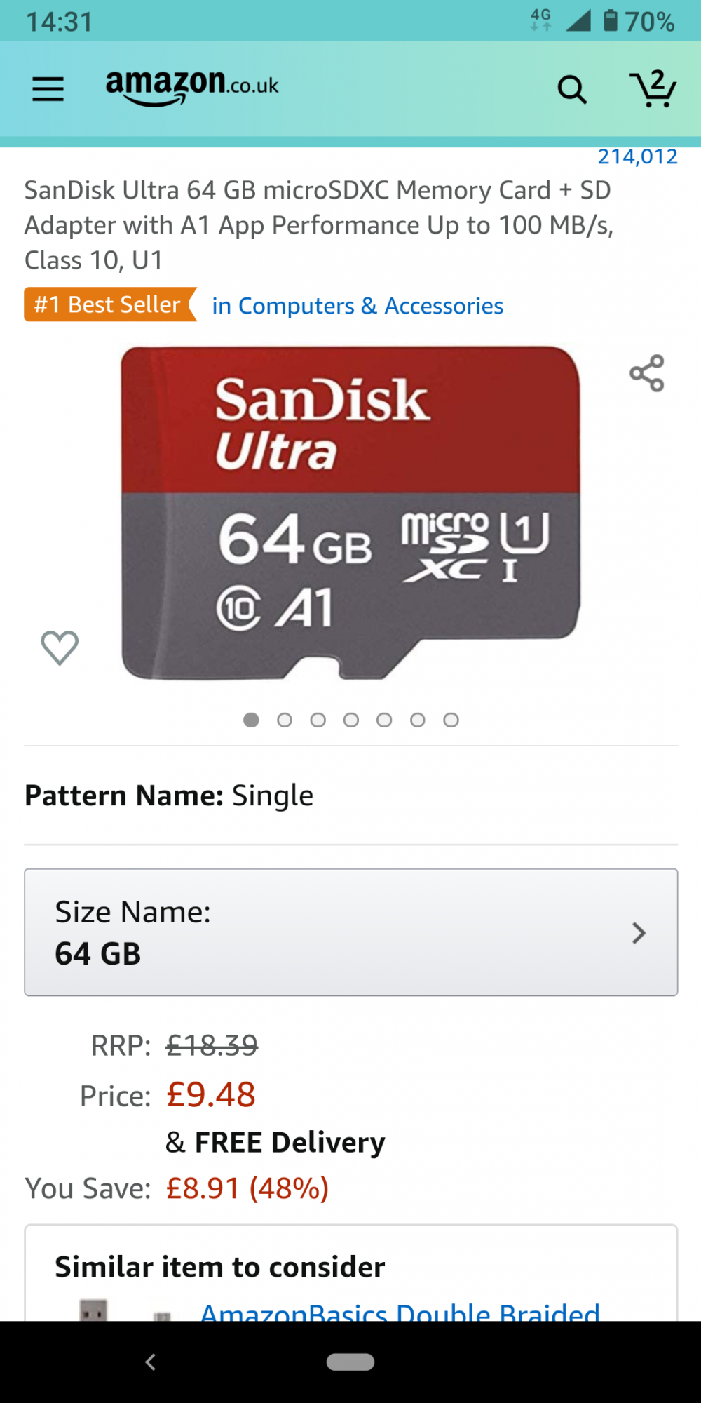

Red and grey sounds like a SanDisk card. Any chance you can download the SanDisk "Memory Zone" app which is 68mb. At least it may identify the issue and there are some tools there, along with a manual on their website.

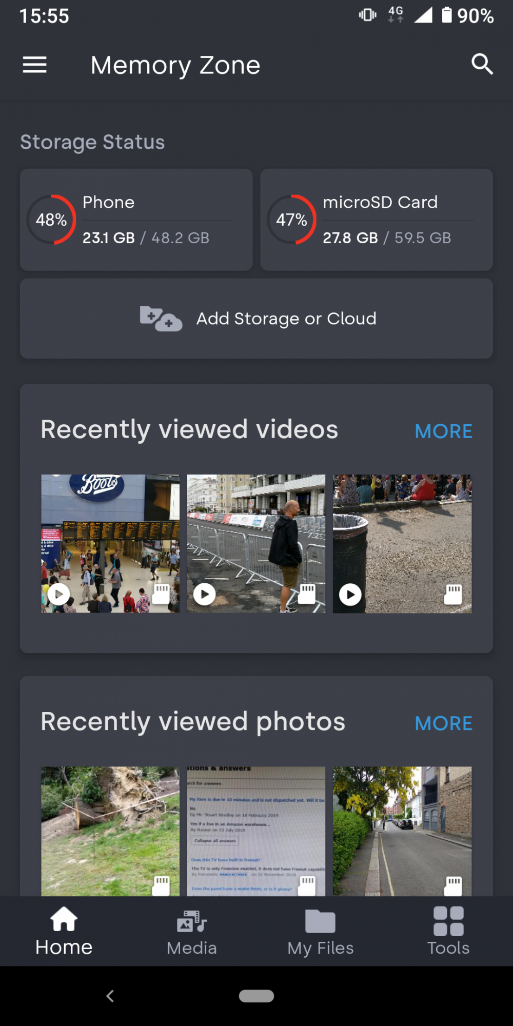

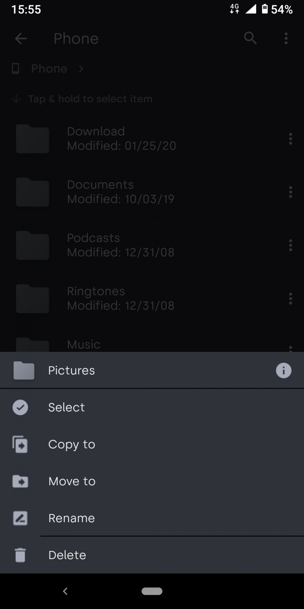

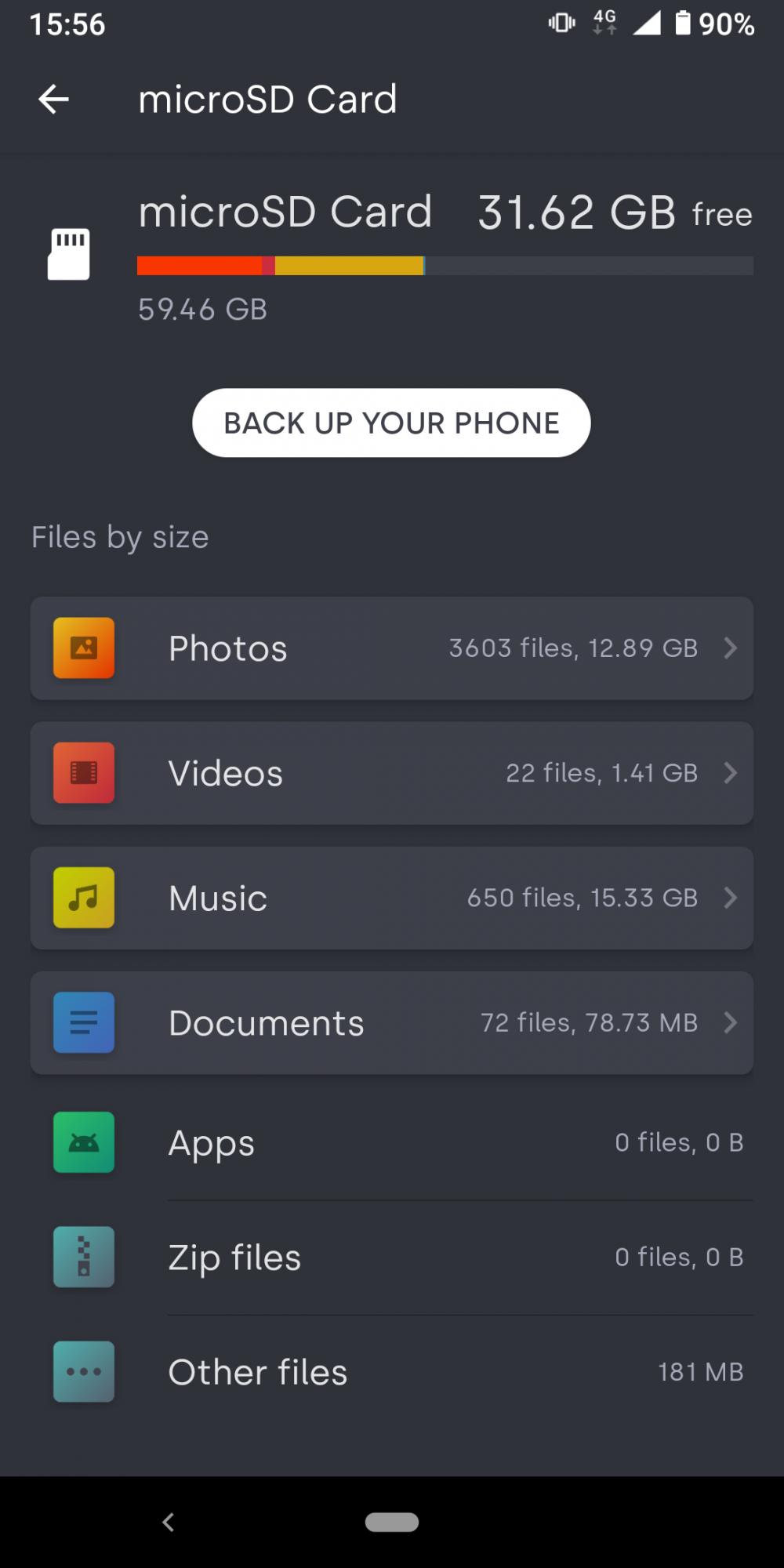

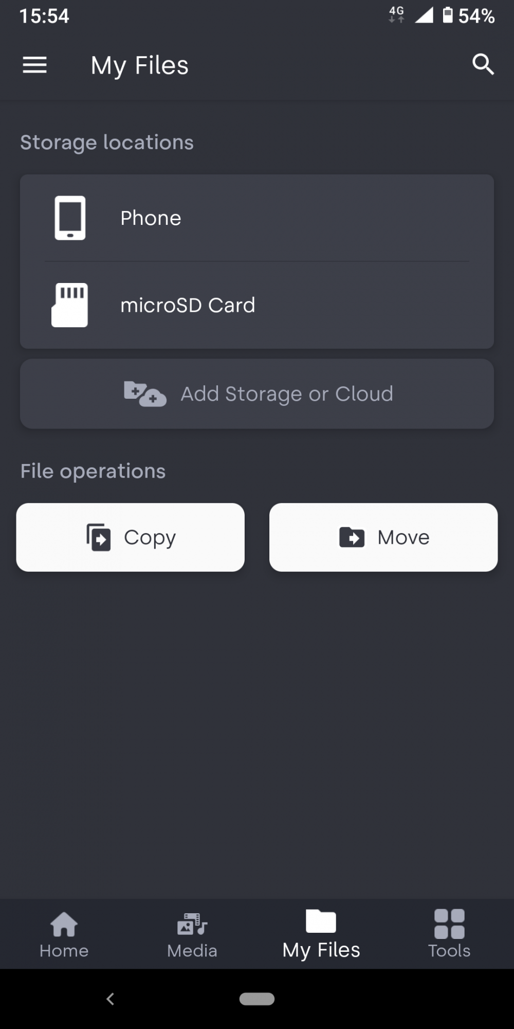

I just tried using Memory Zone to move files to sd. As far as I know I have not. It's confusing, just going around and around while I try to give MZ permission and it keeps showing how but it doesn't work. Is there a simpler way? Could My Files or X-plore help?
You don't want to keep the SD card in the S5 for now? I don't have a Samsung anymore, but on my Nokia (which I also may need to replace as cheaply as possible) on the Camera app I can choose to save new photos to SD card.
For transferring you should be able to either use Samsung's file app (is that My Files) or the Memory Zone app - my files.
You don't need the Memory Zone app anymore if you're stuck for space.
