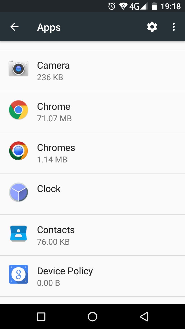

So recently I've been getting notifications that an app called "Chromes" is malware and it being clearly fake I uninstalled it but it keeps reinstalling itself and I can't get rid of it at all and it has permission to access everything on my phone. I've tried loads of different anti virus apps but all they do is uninstall it and a few hours later its back and even tried resetting my phone and it still persists. Can anyone help me get rid of this please? Thanks

Check your device Administrator and see what app you as the administrator
