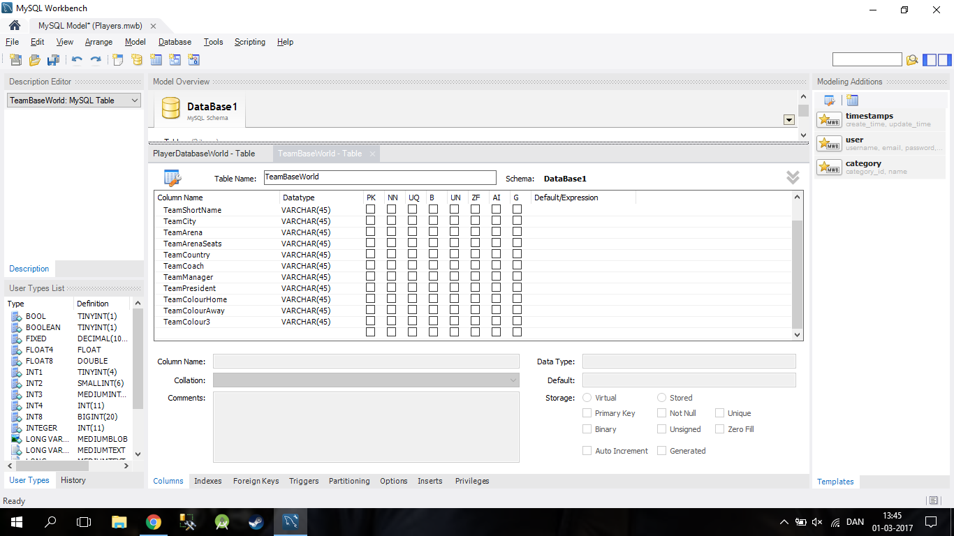

I will create team database...
but problem is that i don´t understand how this works ( the thing on the picture )
someone who understands better than me ?:)
Looks like you're trying to create a table called TEAMS.
Any database table needs at least one column in it, to be of any use at all. In that dialog window you have open, you need to type something in the 'Column name' box. You also have to select a Data type.
But really, you need to read through a database beginners guide. Otherwise you're going to struggle with this.

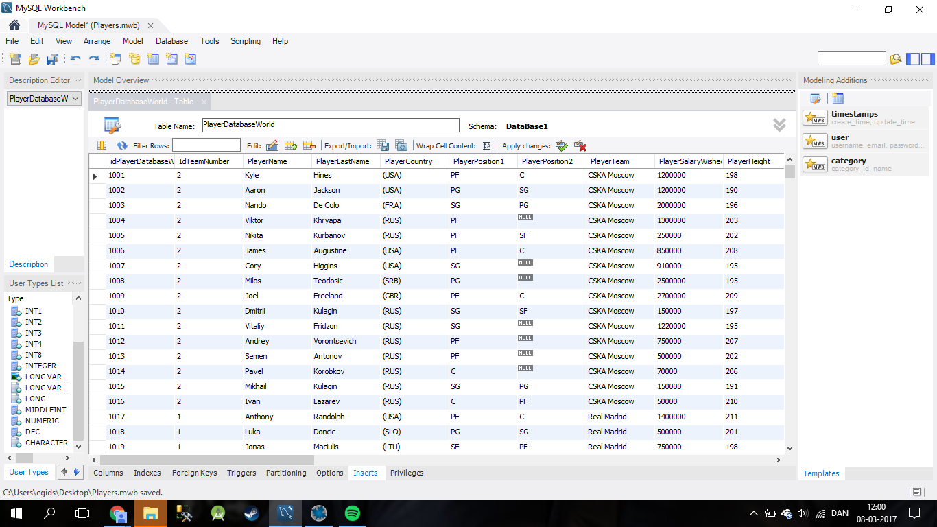

So now i have created a database with players and teams....NOT finished yet, but still... :)

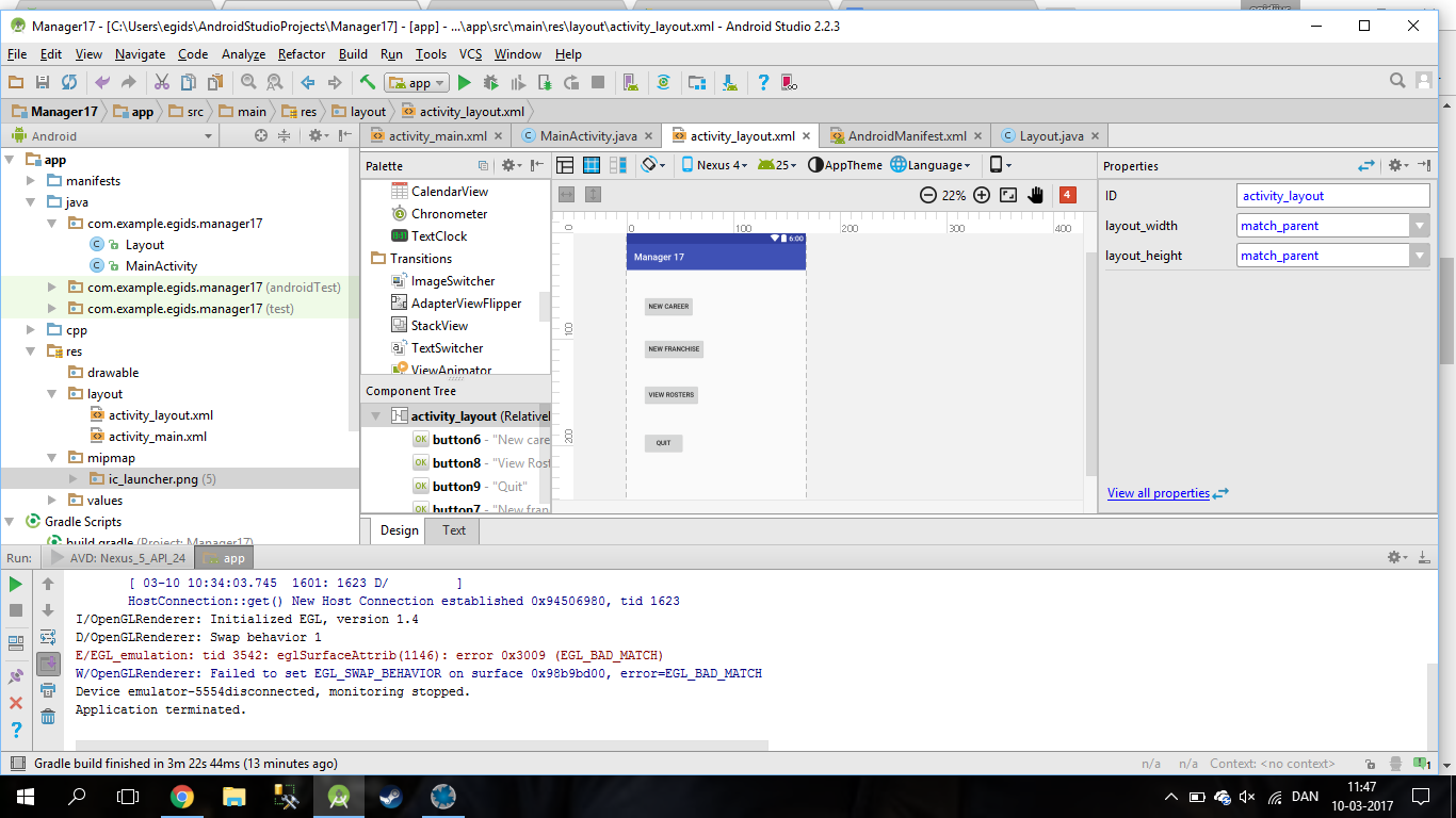

so that is how my menu should look like at the beginning :D
