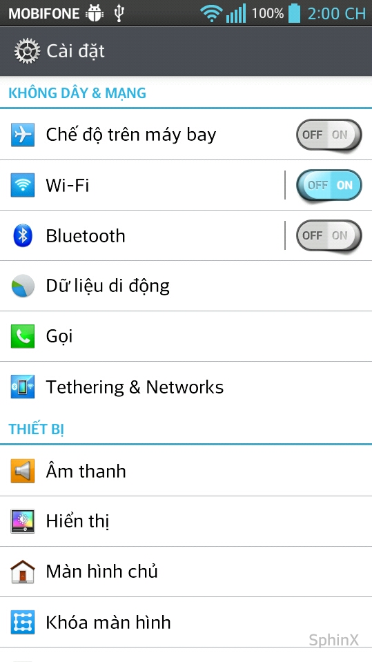

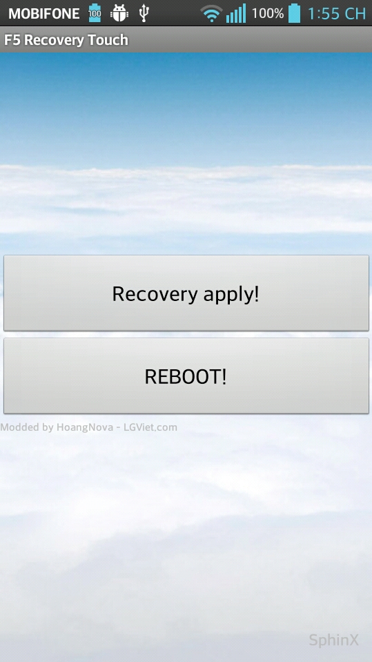

Hello friends,
Recovery and ROM for LG P870 here
Please use google translate
Sorry for my bad english
lgviet.com/forum/threads/huong-dan-root-recovery-lg-escape-p870-lg-f5-phien-ban-at-t.5479/
