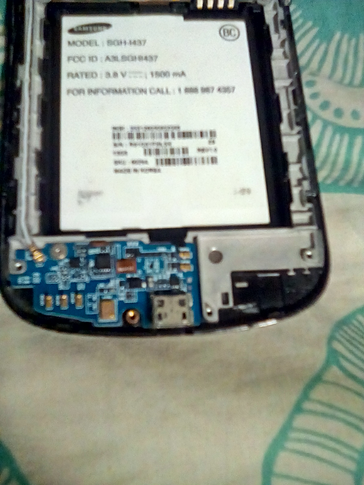

My Samsung galaxy express sgh-I437 has seen better days. I had to buy a battery charger, because the charger port broke, and I couldn't find a replacement anywhere I looked. Now, the back and home buttons don't work. I don't believe it's because of taking my phone apart. They don't light up either. Any help?

It's almost certainly a hardware problem. Are you sure you didn't disturb or damage anything around the bottom area, like the fragile flexible print connections between the front parts and the main logic-board?
I hope this helps.
If they don't light up now, it's likely that their wires are disconnected. Take another look at things there, maybe you forgot to put back a connector. They could also be damaged as Mike said... In that case, it's not easy to fix this. For now, you can use an app that gives software navigation buttons...
When I put it back together after taking the picture, I did find a piece of hair, so I'm going to put the battery in and see if they light up now.
I didn't see any disconnected wires or anything, but I found a piece of hair, so that might of been a problem. I'll try turning it on and see if that fixed it or not.
The white wire connecting the bottom area and the main logic board is kind of pinched in places, but I don't know if that is messing with anything, because my home button still works.
Oh, okay. I turned it on again, and they still haven't lit up yet. I guess I will have to download an app. That's a bummer.
