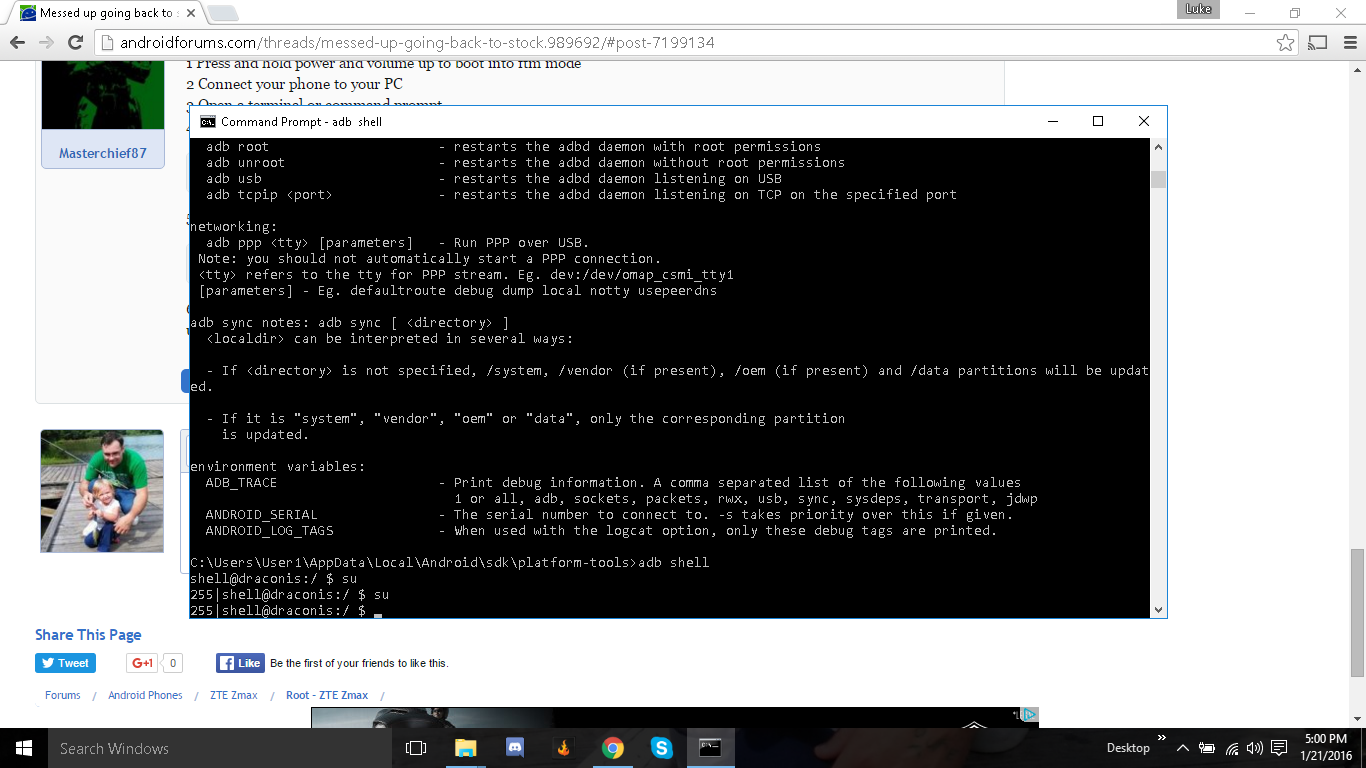

assuming that it is fried... Any attempts to sideload a restore image returns could not read... I will check in later and see if you have answered... thank you for your time...
I can run the following... I saw someone post that if no error pops up run this script... I have not run it but it appears that i have access to root if i can write to cashe... Sorry for spamming...
The only way to fix your phone is to get root in adb shell and use it to flash twrp, then use twrp to correctly flash a ROM. Adb sideload won't work because the stock recovery can only install zips signed by zte with their private key. I couldn't read the second and third screenshots you posted but in the first one I could see that while you do have access to adb shell, you do not have root access.
Sorry but there is nothing I can do at this point.
