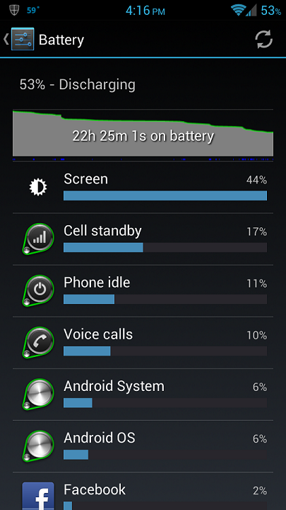

Battery life with moderate usage, including tapatalk, mms, several phone calls, waze, github app, Google Chrome and an hour or Netflix (walking dead :thumbup:) :
Not bad :D

As far as my setup I'm using the voltages in post 3, Wheatley governor, io is set to sio, running at 1.6 ghz, set option immediately on boot.

I set my voltage to ChiweN's suggestion and didn't have any issues until I ran Facebook and I got the reboot. Up'd everything up 15 and everything is running smooth, getting pretty good battery life for what I use the phone for.
