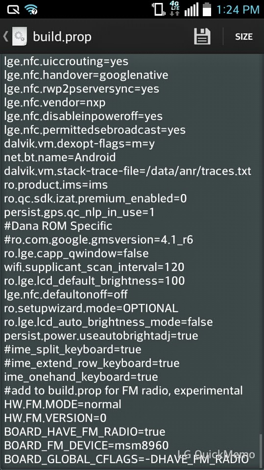

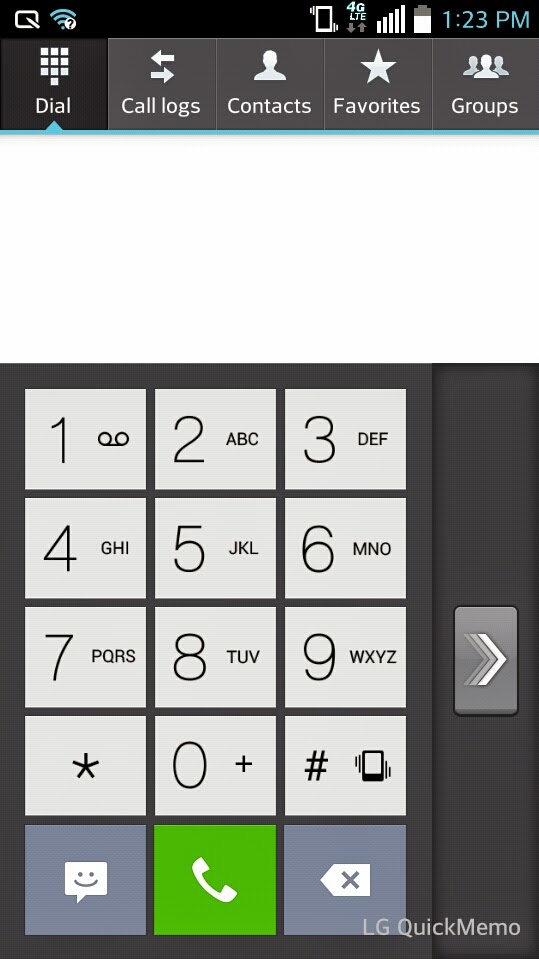

Just wanted to share easy build prop tweak here.
This prop change will work on stock ROM or stock-based ROMs only.
ime_onehand_keyboard=true
ADD
This line enables one-handed operation mode on system setting. Usually this mode is default enabled on phablet size phones but not on F6.
Add this line on build.prop, save it, restart phone, go to phone system setting then you will see new option is added between Lock Screen and Storage.
Screen Shots

I think this would be a great place to post tweaks. Make sure to list current ROM and version.
@bard, at the bottom I see you're trying FM radio on F6. I thought the F6 runs msm8930? The D505 is also on 8930 but has FM radio enabled. Anyone with a D505 on jellybean or kitkat post their stock build.prop?
@ Hus,
F6 runs msm8960, same as LG Motion and LG Spirit.
If you look files and stuff... F6 has some framework and apps that cooperate with LG FM Radio app. LG FM Radio appears on Qslide, it has its own icon on notification bar.. But again, it's missing drivers and all necessary files.
Actually... F6 is missing more files than LG Motion.. I was able to turn on fmconfig script with LG Motion and Spirit but not with F6.
So far I copied some library files but very slow progress so far ><
@ Hus,
Are you sure it's 8960? Every other site including LG mention 8930. I thought 8960 comes with adreno 225 and 8930 comes with 305? Good luck, I hope something works out.
You are correct! It's 8930 lol
Why on earth build prop says it's 8960 though??
P.S.
I guess LG made F6 firmware based on 8960. If you change this to 8930 on build prop, you will get boot stuck ><.... KDZ'ing now... ** Keep ** build prop value as 8960.
