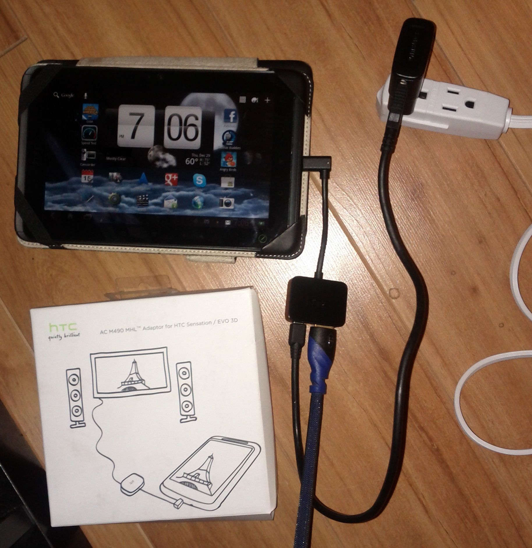

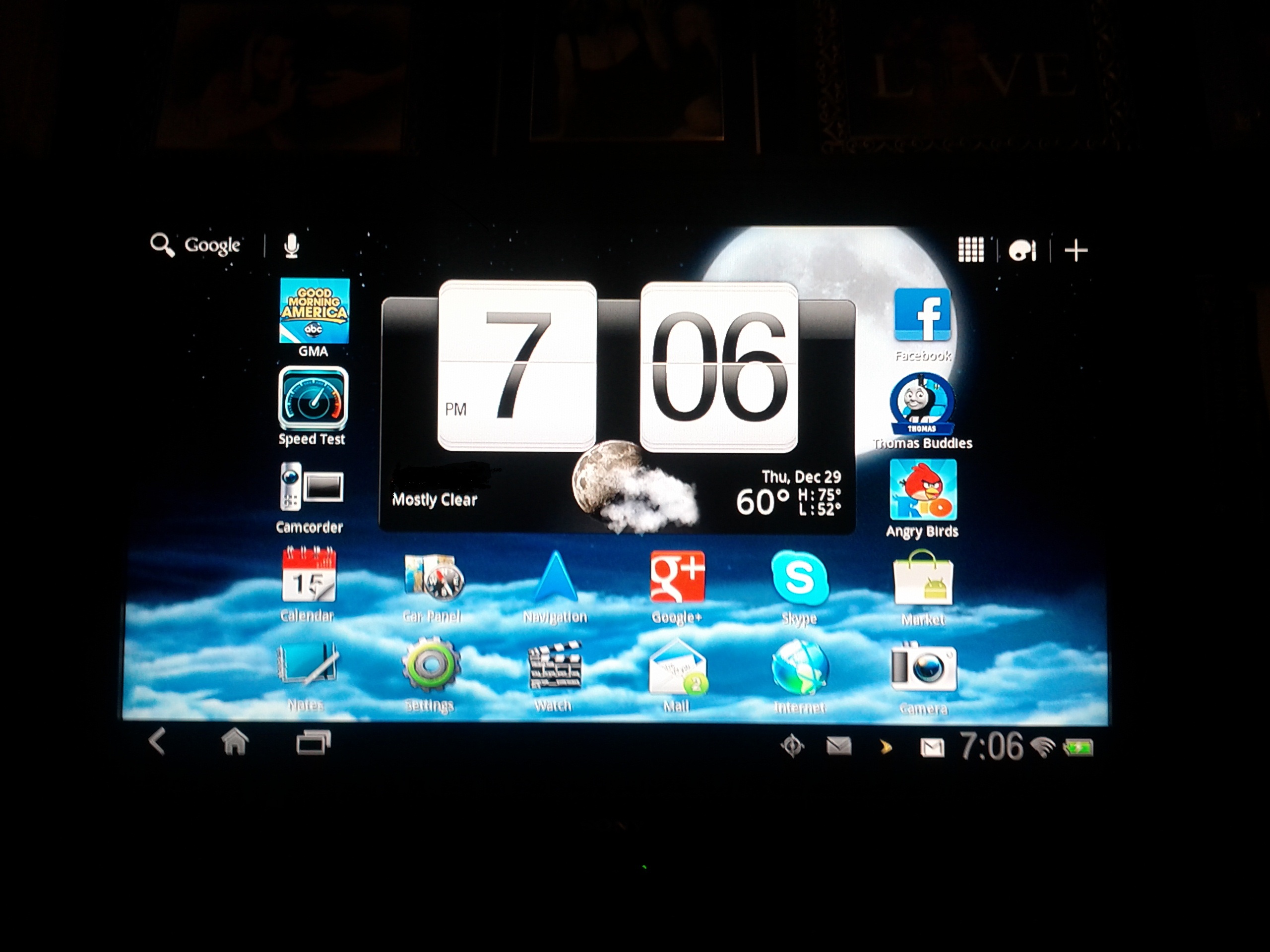

Ok this is the way I did it. Most of the time I keep the cables tucked back behind my TV. I hope this help ya :D

I'll try again in that order and get back to you. So that's the HTC mhl connector? Is the power connector port on the mhl adapter larger than micro USB like it is on the view? Because I have a generic NHL adapter from Amazon and the power adapter is standard micro USB shaped.
