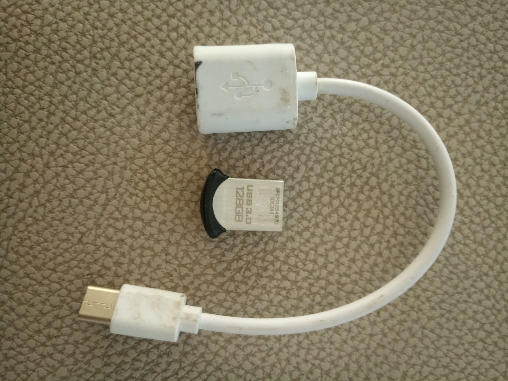

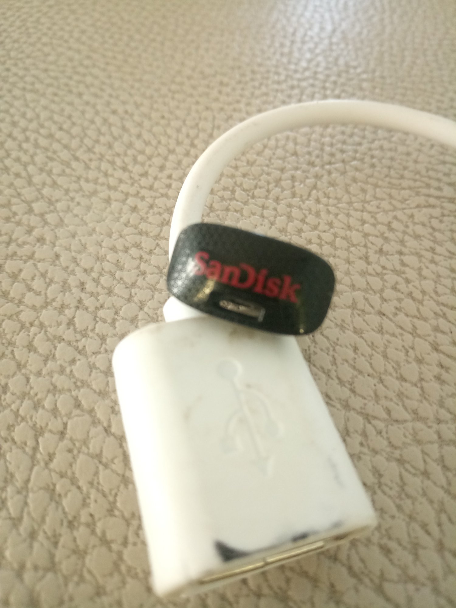

That's working. I use sandisk 128gb. usb 3.0 connect to usb c cable convert to usb 3.0 port only.
(not usb 2.0 port)
