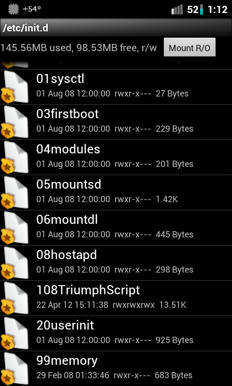

2, Place file on your SD-card. (USB Dropbox, doesn't matter how)
3, Use Root Explorer or Root Browser Free and move the file into system/etc/init.d folder. Remember to hit the tab that makes the folder Read/Write as Read Only is the default setting for most File Explorers.

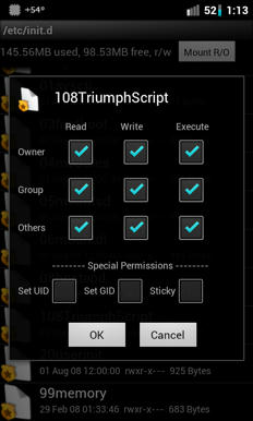

3, Give the file full Permissions.
4, Reboot! (Will take a bit longer to boot and will appear to be held up on the Motorola Logo for a bit. This is nothing to worry about, the script is running and the Tweaks are being applied.)

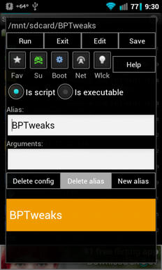

2, Install Script Manager Free from the market.
3, Open Script manager and select the script.
4, Select SU, Boot and then save.
5, Reboot! (All Build.prop Tweaks will now be applied during each boot unless un-selecting the option in script manager or deleting the script from the SD-Card. This will not make any actual changes to your Build.prop. Nor will it effect any properties associated with Market Access.
