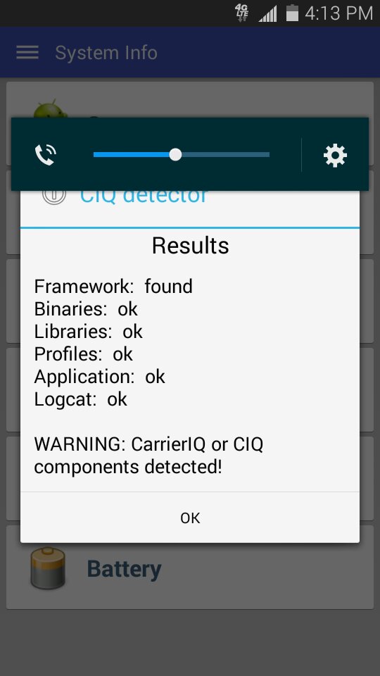

I flashed the Knox / Carrier IQ remover zip through TWRP recovery but Knox is still showing up in my list on Titanium Backup and I get this message when I do a sysyem check for Carrier IQ . I do have knox frozen in TB ; could this be the problem and is Carrier IQ somehow tied in with Knox ? Any help is greatly appreciated, Thanks !

I know I am way late but I finally got this CarrierIQ/ Knox garbage off of my phone thanks to Mastercheif87 for the .zip . I had trouble the first time I tried because I had Knox disabled in Titanium Backup . Apparently the app I was using to detect the Carrier IQ still picks up certain components of it still on the system even if its main files have been removed and it is inactive . I tried another app yesterday after flashing the zip again and it said it was gone while the original app still detected some CIQ components. Thanks again for the easy to use .zip .
