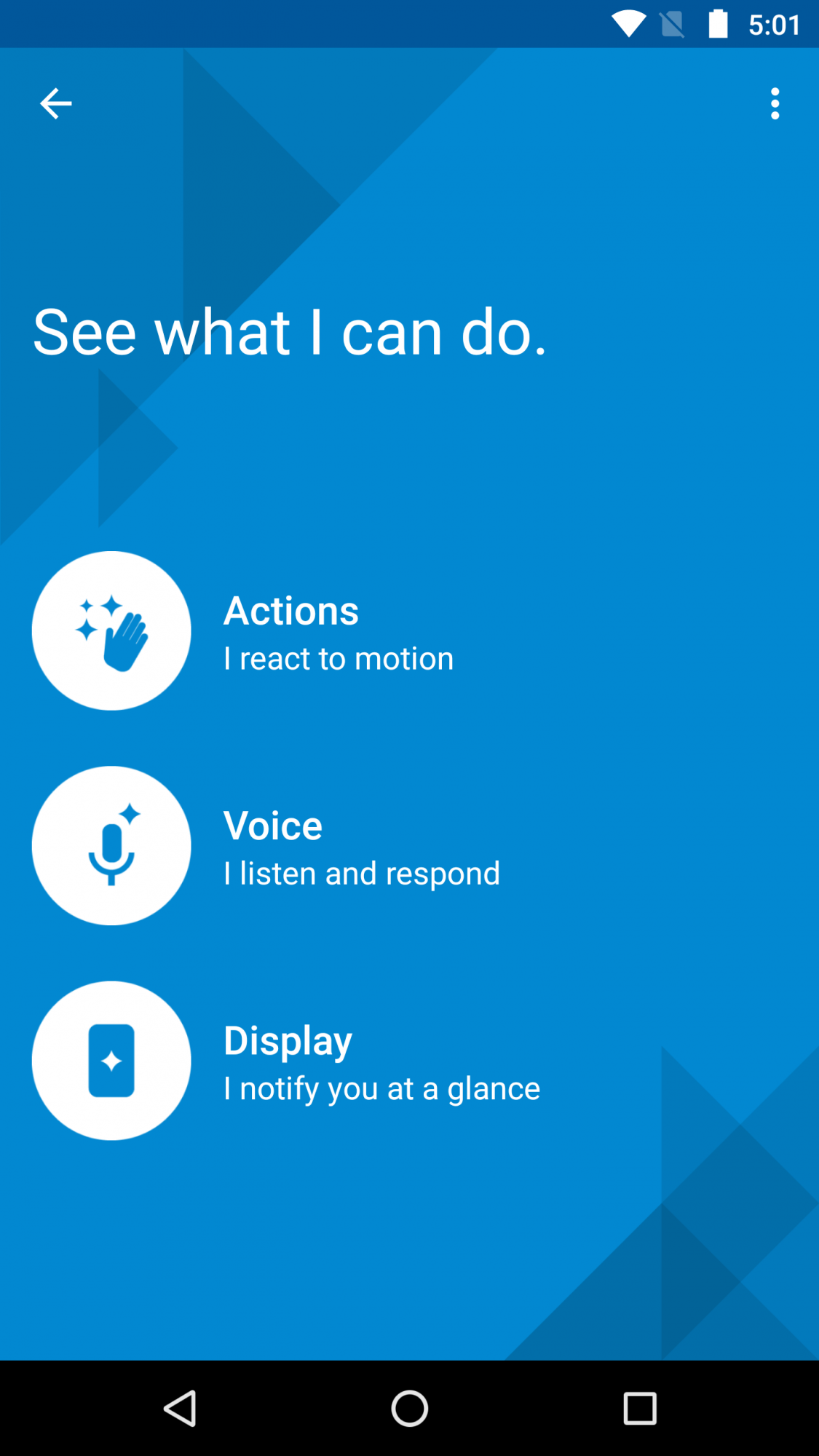

The motion display on my Moto X Pure Edition is not working, how can I get it back on my screen? I also have other issues that I need help with. Thank You for any help with this and help with my other issues. Fairly long list of other problems.
You should be able to activate it through the Moto app.
THANK YOU for taking your time to try to help me! I did do that earlier today and it is [on] so that is not the problem. My phone has other problems also. My phone turned off by itself while I was using it, then I couldn't get it to power on. I messed around trying different things, finally I got it back on. It's was 97% charged so the battery doesn't seem to be the problem. It keeps doing this and i figured out it will not turn on only when the charger is plugged in to it and as soon as I unplug it from the charger the phone shuts down. The only way I can use it is to keep the charger plugged to it. When I was trying to get it on as I explained above, at one point the Android robot was on it's side. It it said the battery was OK. in red letters it had, AP flashboot Flash Mode (secure). Device is LOCKED. At the bottom of the list in green letters was, Fastbook (or boot) Reason: Volume down key pressed. I think I was in that mode and it was different test when I tested the sensors, it didn't work, it said failed. So somehow the sensors aren't working and that is probably the problem with Moto Display. Do you have any suggestions for me to try to get them to work. Sorry for the long explanations. Thanks again!
