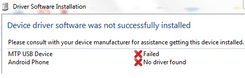

Have tried 3 times, including today after there was a further update. Every time it connects, it seems to try and find 5 drivers, and fails to find 'Android Phone'... which is strange considering the last 3 phones I've had were Android - I guess it's not as generic as the name sounds.
I've downloaded the Driverpack Solution 12.3 on your link. I searched for 'HTC One X' but it found nothing. So then I tried to connect the phone whilst the driverpack solution was open, thinking it would auto-download the driver. But it was just the normal windows attempt, with the attached result.
Can I just downgrade back to ICS?

Try this with your phone connected, go to control panel & get to the device manager screen.
Locate your phone which should be the only unknown device & click to delete it.
Now go to control panel & select add a device, see if you can get it to pick it up properly there.
Good luck.
