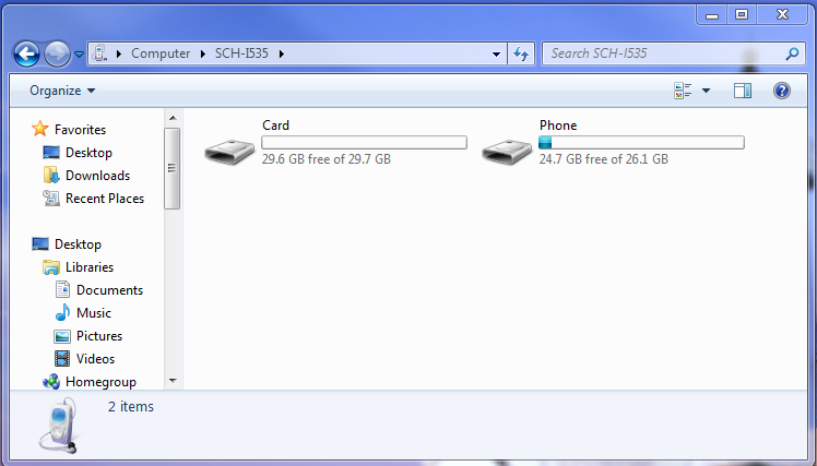

Looks like the Samsung S3 is *really* picky about the micro usb cable used........
As it turns out in my case, I tried a couple, including the Samsung one supplied with the phone.......
Got it to connect once fine, then all kinds of issues (e.g. code 43, device not present, half installed devices).
Then on a whim, I tried some *more* micro usb cables I had around......
I finally found one that would consistently work (no, not the one supplied by Samsung) with the Developer Options USB Debugging mode turned on.
I could then toggle between Media device (MTP) and Camera (PTP) mode by dropping down the notification bar (that had the USB icon on it).

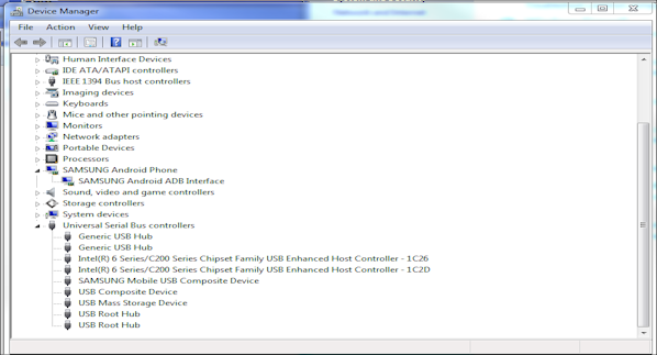

As I switched modes, different Windows 7 (64 bit in my case) drivers installed:
Media Device (MTP)
SCH-I535
SAMSUNG Mobile USB Modem
SAMSUNG Andriod ADB Interface
Camera (PTP)
SAMSUNG Mobile USB Composite Device
SCH-I535
SAMSUNG Android ADB Interface
This is the *actual* USB device (often marked as unrecognized with warning triangle):
Also attached some screen shots.....
BTW, if your still having problems, Air Droid (via WIFI) might be a viable alternative. That was what I was using until I found the magic cable :)
For reference, I am using a Pebble Blue 32 GB Samsung Galaxy S3 and Windows 7 Ultimate 64-bit on a HP i7 desktop.
