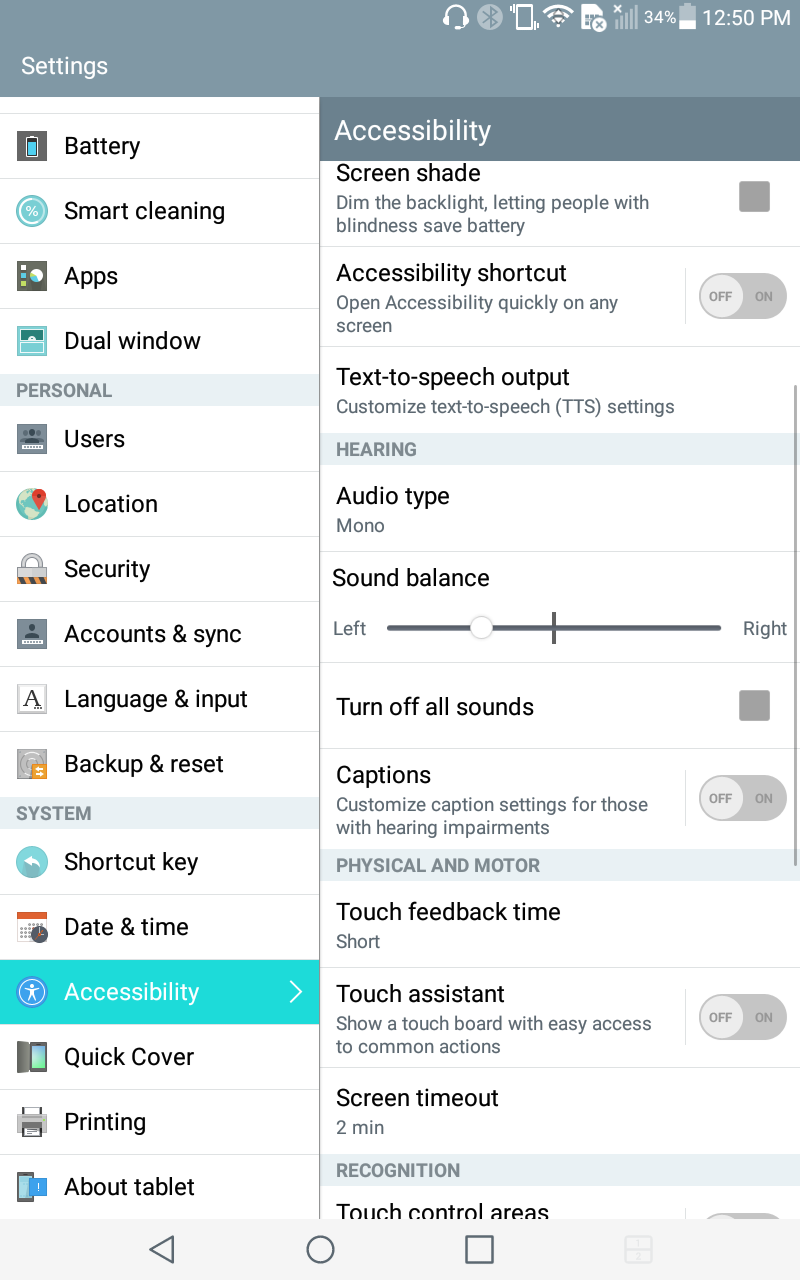

I know this thread is old but I have a LG tablet but this will work for Any android device. I was only hearing the music, like an instrumental and the voices were so low. Even on high volume. What I did was go to my settings and then click accessibility and adjust the sound to wither the right or the left headphones. Make sure you have music playing when you do this so you can hear the music. Either way right or left should do the trick but do it to which sounds better. If this doesnt work your head phones or even the jack might be broken.
