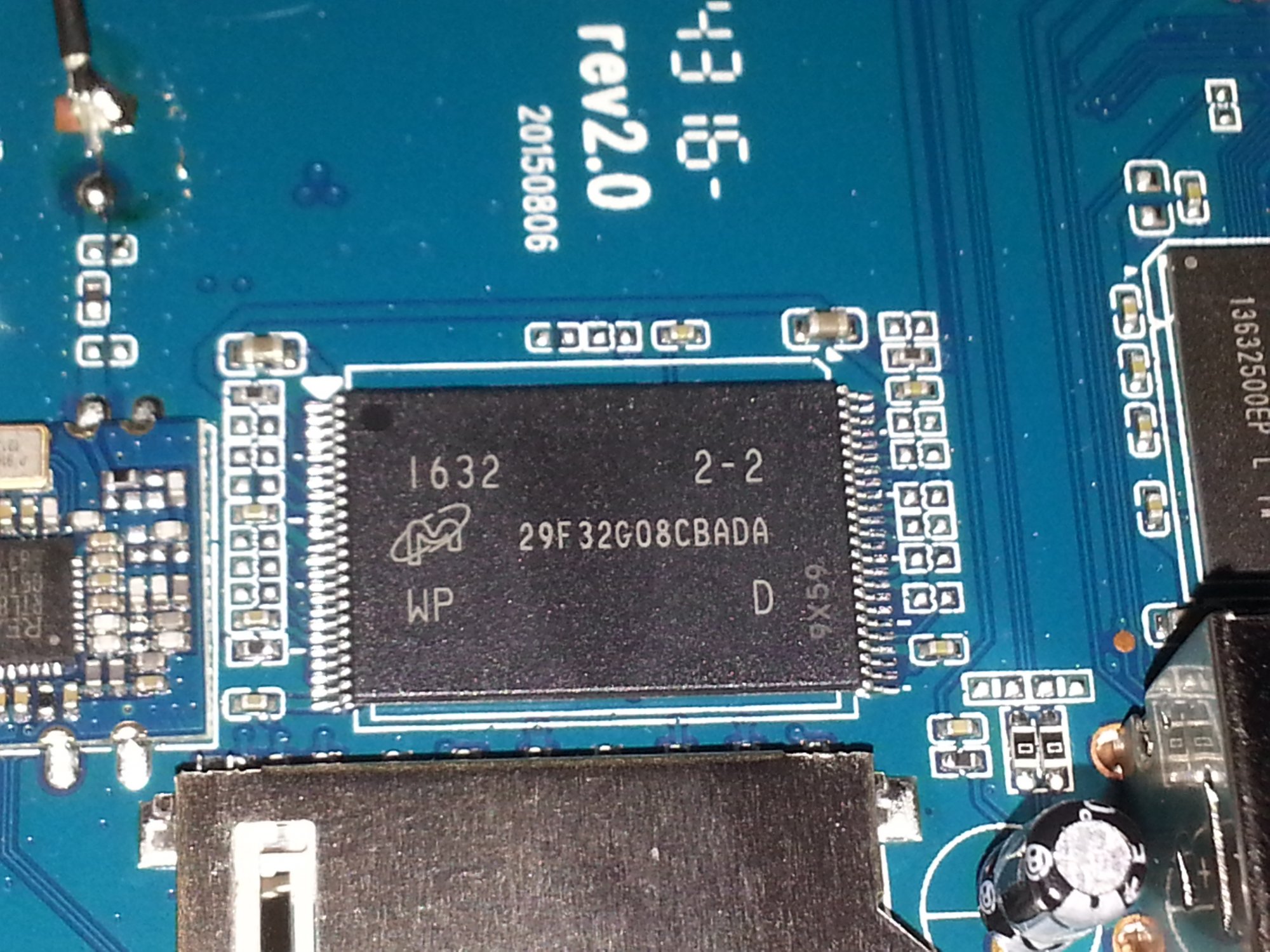

I have been buying android boxes in bulk and reselling them for some time now. I recently purchased from a seller on DHGATE. I tried repeatedly to install my (Gaming kodi build) onto the box but to no avail. The internal memory is showing i have 5gb available. Im trying to transfer only 2.0gb to it. Es file explorer repeatedly says task failed and when i check the capacity it says it is full (I checked before the transfer and only 11% of the memory had been used.) So i decided to try a different rom. When i installed it. All worked well until i checked the capacity of the internal memory. Now it is showing true capacity at only 1.81gb. So i then took the box apart and looked at the nand chip. The chips part number is MT29F32G08CBADAWP, Which basically boils down to a 32gb nand flash chip from micron technologies. My question is how in the world can i get the full capacity out of this nand?

Could be a faulty or buggy firmware and storage layout build. And frankly the only peeps who can really fix that is the whatever unknown Shenzhen OEM who made the thing.

Sounds like it's probably a factory reject chip, that's not 100% functional, and the module and Android build was made up to use them. And if an attempt was made to make full use of it's stated capacity, it wouldn't work.
There's a massive trade in B and C grade components in Shenzhen, which often end-up in the knock-off Apple iPhones and Samsung Galaxys, and the many off-brand things sold cheap from Ebay, DHgate, etc. These anonymous cheapo "MXQ" type devices are literally thrown together, like hurriedly assembled on a table a shopping mall backr0om or a shed somewhere.
There's malls where you can walk around the booths, and buy A, B and C graded NAND, SRAM, etc. and just about anything else by the handful.
