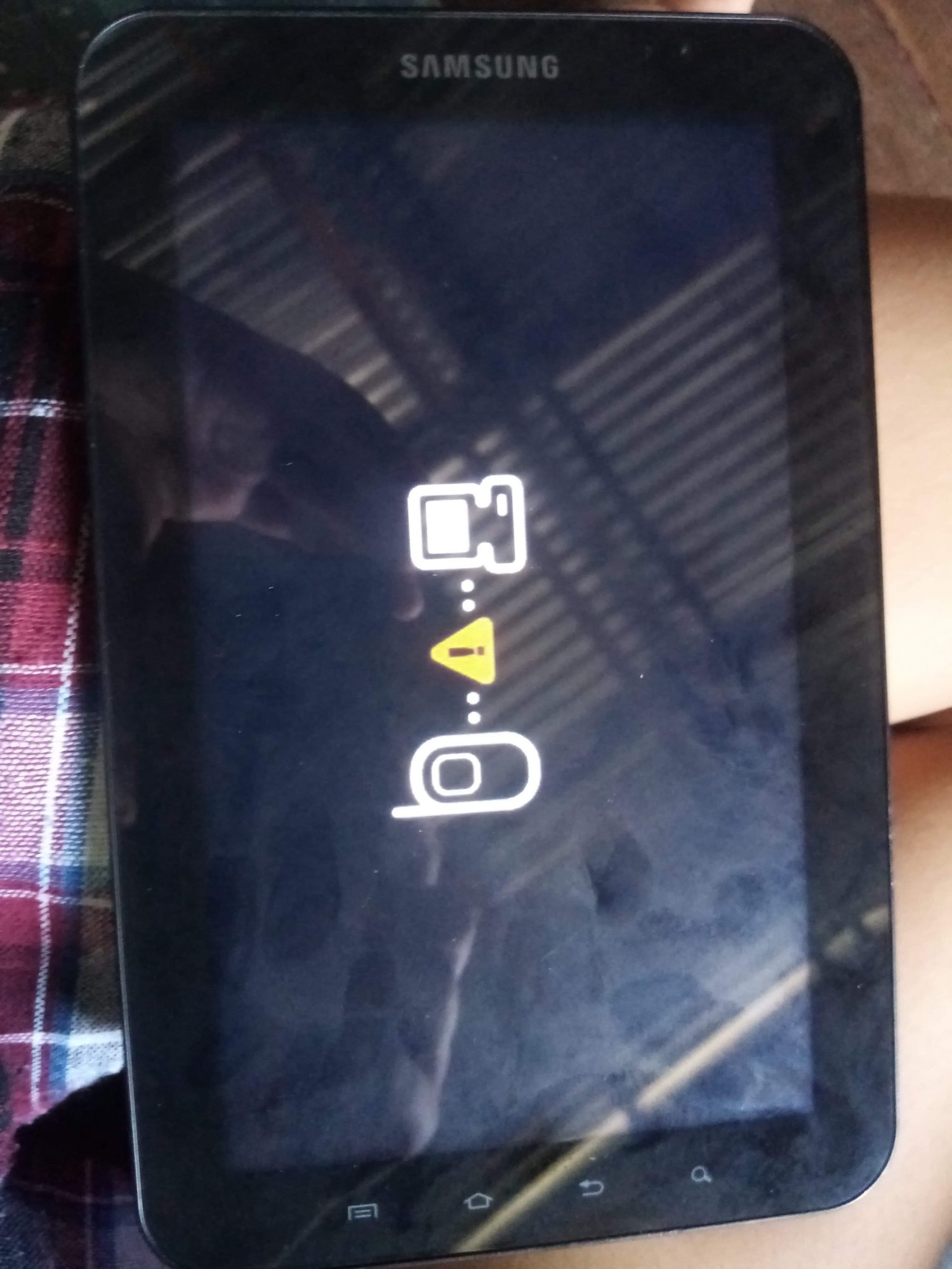

I tried to flash full stocm rom with odin but it failed. So i turned the tablet off by holding the power button... And then this image just popped up. I don't know what to do, i tried to go to Power reset or unknown upload mode but the screen turned black. I charged it but it doesn't boot up. Help anyone?
Btw my tab is stuck at Android 2.2 FROYO.

where did you get the firmware update from? do you have a link? are you sure the update was for your specific device? flashing the wrong one could soft brick your tablet.
Where did you download the ROM you used and are you absolutely sure it was the correct one that matched your model?
When a Samsung device fails to boot up after being flashed, it could just be a matter of re-flashing it but typically it's because the wrong ROM was used. ROMs are not interchangeable with each other, they're very device specific.
Go here, select the ROM that matches your country and carrier. Don't experiment with a different ROM, download the one that's made for your model.
https://www.sammobile.com/samsung/galaxy-tab/firmware/#GT-P1000N
You'll need to create an account to download the necessary ROM. The download page has basic instructions to follow to do the flashing process. Reboot your Tab into its Download mode and follow the directions.
https://www.hardreset.info/devices/samsung/samsung-p1000-galaxy-tab/download-mode/
Given you have a rather dated device, you might be better off using an older version of the Odin utility. If that's case, here's a link for all Odin versions and use vers. 1.85
https://www.droidviews.com/download-odin-tool-for-samsung-galaxy-devices-all-versions/
