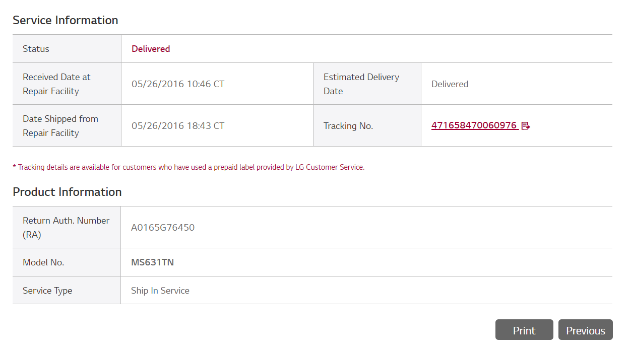

May 24, 2016
Issued a first RA# (Return Authorized Number) A0165G76450
May 25 - May 26, 2016 (2 days)
LG Repair Department received, fixed and sent it back quick.

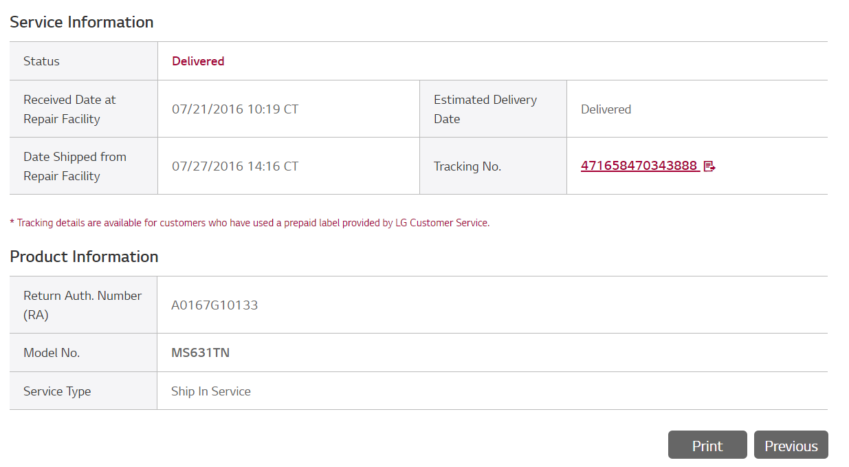

Issued a third RA# A0167G10133
Special instruction attached saying replace a whole motherboard
Jul 21 - Jul 27, 2016 (7 days)
Due to escalated status, repair took a week.

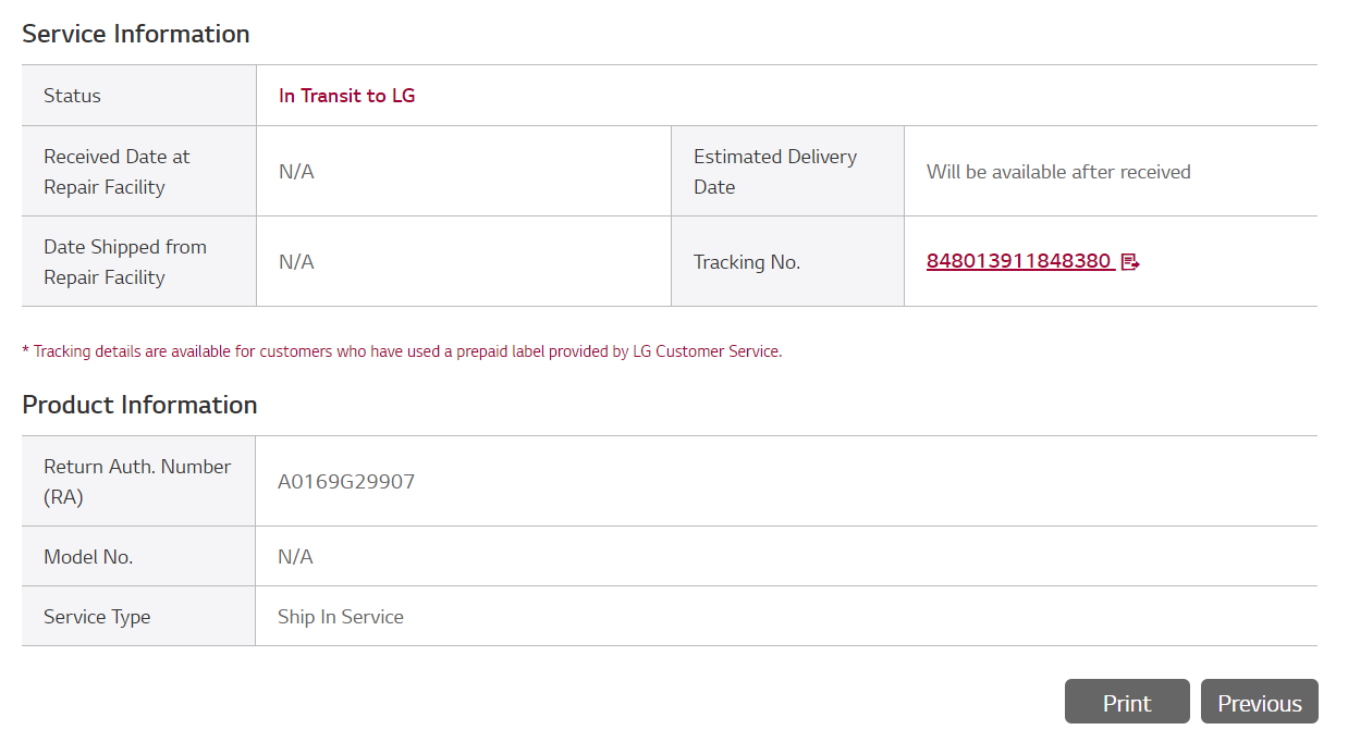

Issued a fifth RA# A0169G29907
Customer Serviced attached a note saying this is a fifth repair and need complete replacement on parts.

Repair Status Screenshots
Notice how they repair (usually just resetting the software) then ship it back...

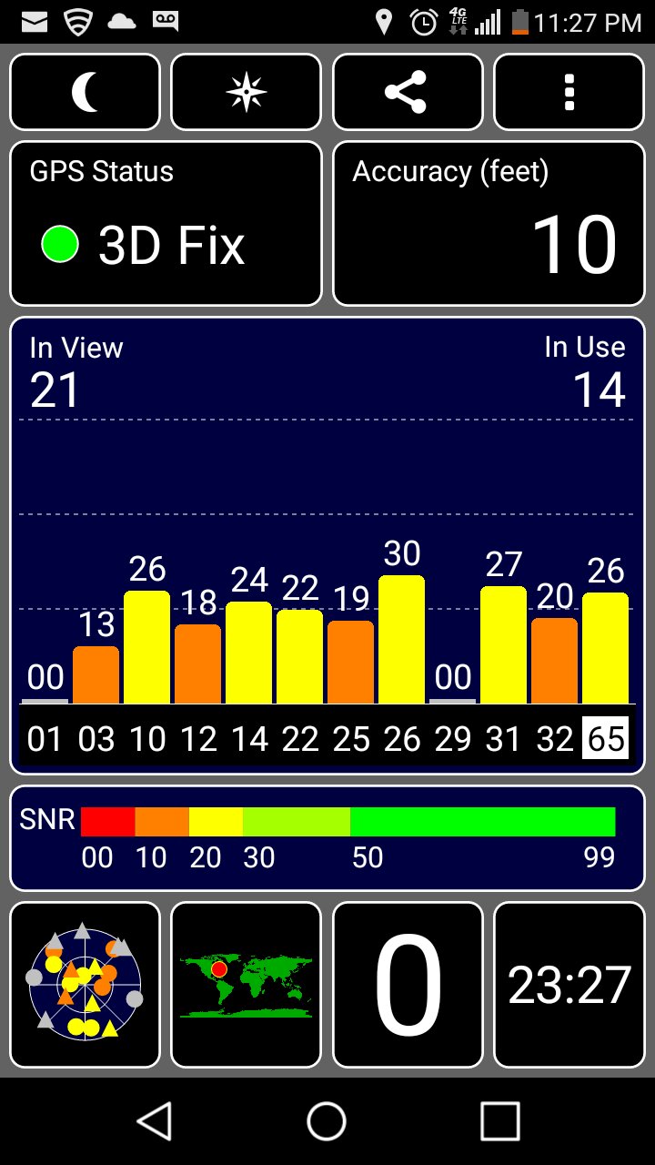

G Stylo (6.0) reading, Nexus 5 reading, respectively, after first fix attempt. Close enough, will have Mrs. test for me tomorrow.
I didn't think to capture a test of Stylo BEFORE the repair, but my other Stylo GPS is crap also. Side by side of the two Stylos (1 fixed, 1 not), will hopefully show some major difference in fix. I'll check back tomorrow afternoon when I have both Stylos in hand, and some input on if the repair even helped.

Sep 27, 2016 - Today
Shipped a device, waiting...
