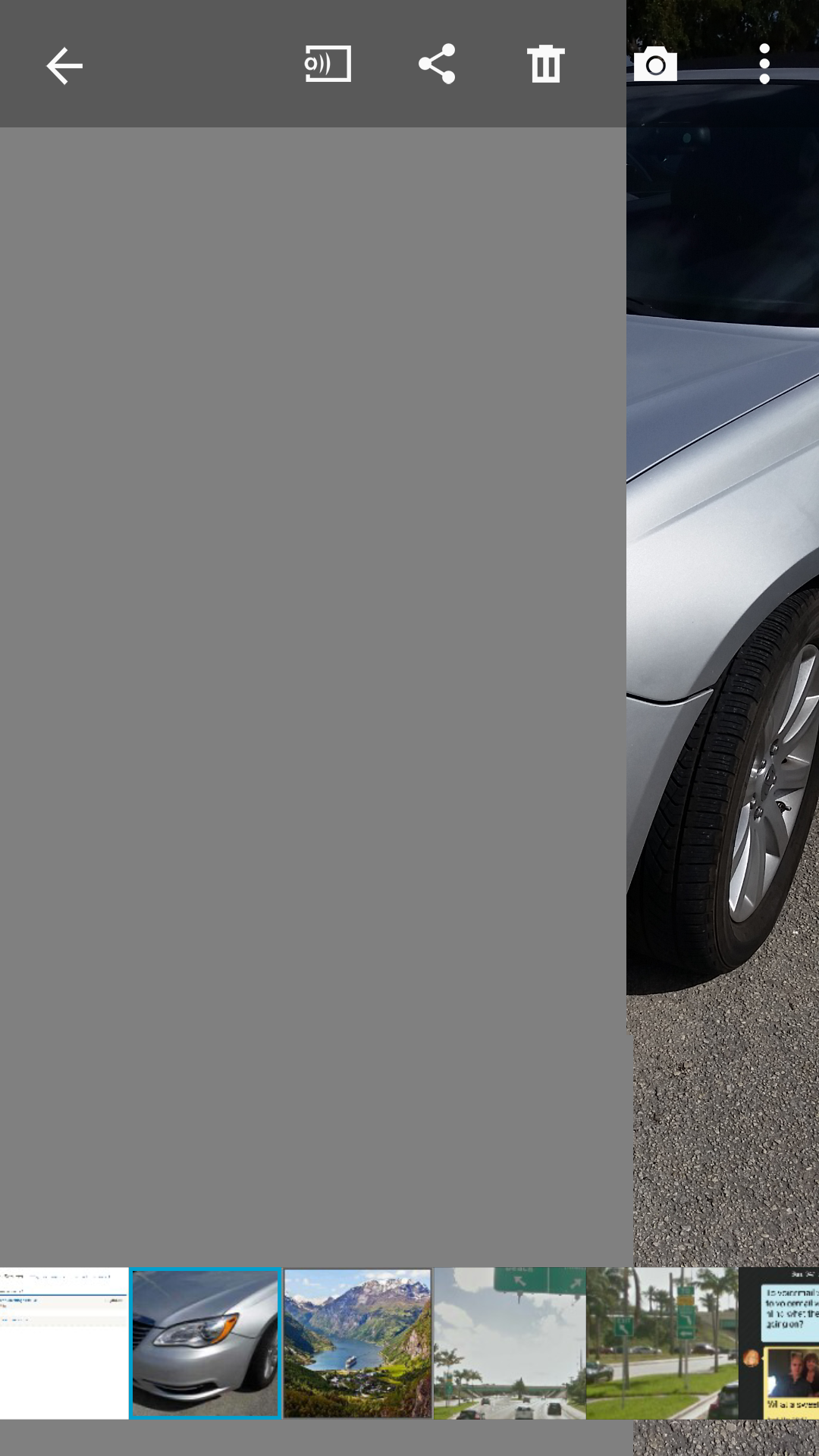

I am having this same problem with my new Samsung S8. Photos are saved to my card. However, not all photos have the problem, on some of them. Took a series of 5 photos today and the thumbnails are fine, the photo opens fine but 4 of the 5 immediately grey out 90% of theach photos as I am viewing them. I texted one photo and it was fine in the text but my original greyed out in the Gallery. I saved a copy from my sent text and it is still find. What is going on?
Same problem on my S5 for the last year or so. It happens intermittently, and can happen with only one of a series or many of a series taken at the same time. Note that the thumbnail is the full image. The grey portion varies from 25% to 80%. I can't figure out any pattern.
On another image, I could switch from another photo to the damaged one and the full image showed for a split second. I don't know if it was showing the thumb or it had a good image and the blocking was happening on reviewing.

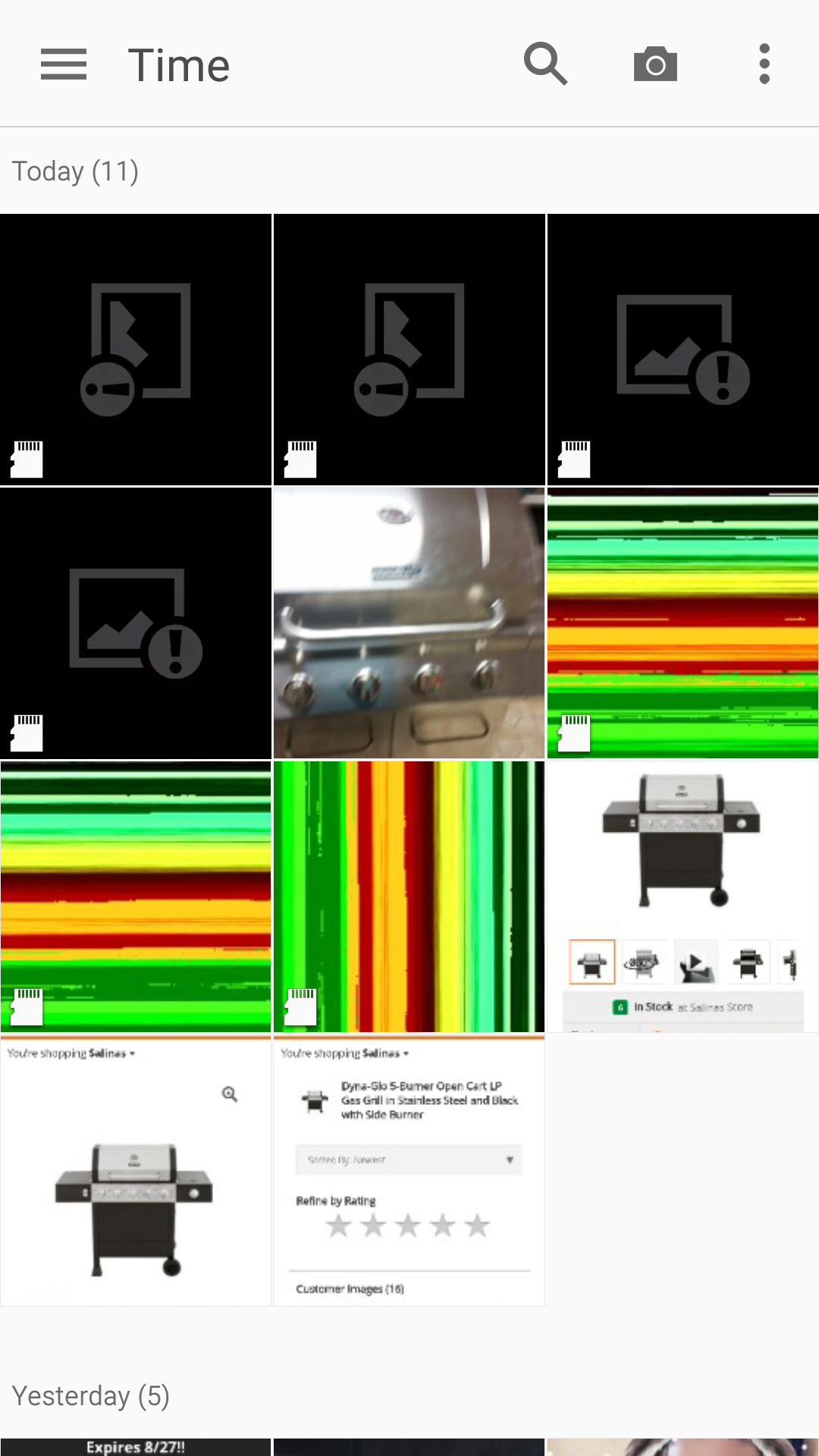

Similar here with my Galaxy S5. Took pictures about two weeks ago - no problem. However, starting today (have not taken any pictures in the interim), if I take pictures with my rear-facing camera and have them stored on my SD card, the pictures are corrupted. I have included a screenshot of what the thumbnails in Gallery look like. The first eight thumbnails in the Gallery screen are pictures I took today. Only one came out (blurry, but that was my fault). If I click on the one with vertical multi-colored bands, it actually displays a good picture. Clicking on the others, the ones with horizontal multi-colored lines or the exclamation mark, displays a grey picture.
Not, upon doing some more experimentation with the front-facing camera, sometimes the thumbnails show the exclamation mark but clicking on the thumbnail will display a good picture.
My phone has automatically done several updates over the past two weeks, so I am guessing one of those updates may have caused the issue, but I am not 100% sure.
No older pictures on the SD card are corrupted - only new pictures that I take.
I tried using a different camera app, Open Camera, and it has the same issues when storing to the SD, too.
Hopefully someone has a resolution, besides doing a factory reset. I'd hate to have to reinstall and re-customize the phone.

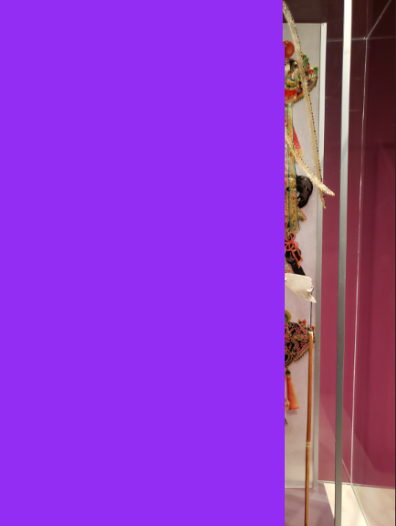

I am having the same problem with some differences on a brand new Galaxy 9. Not all of my photos are affected - some turn out fine. The affected ones are not always completely covered and are not always gray. They are various colors. Also the thumbnails of the affected photos are sometimes covered with a solid color or sometimes with what looks like a transparent colored filter. Only one of the photos comes up with the transparent covering when you open it but the rest are covered with a solid color. I tried to attach some samples of the affected photos but was unable to edit them - kept getting a "corrupted jpeg file" error. So I've attached screen shots. Sample-02.png Sample-03.png Sample-01.png
