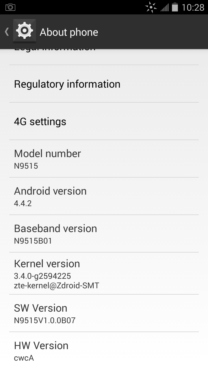

Root N9515v1.0.0b07 and kingroot sucess
arcaina
Just used the newest kingroot after doing the ota update a on stock n9515 b07.
Just an fyi,flashify and twerp,are next
Not sure,this phone has been off in a box for months. She turned it on updated it and have it to me
