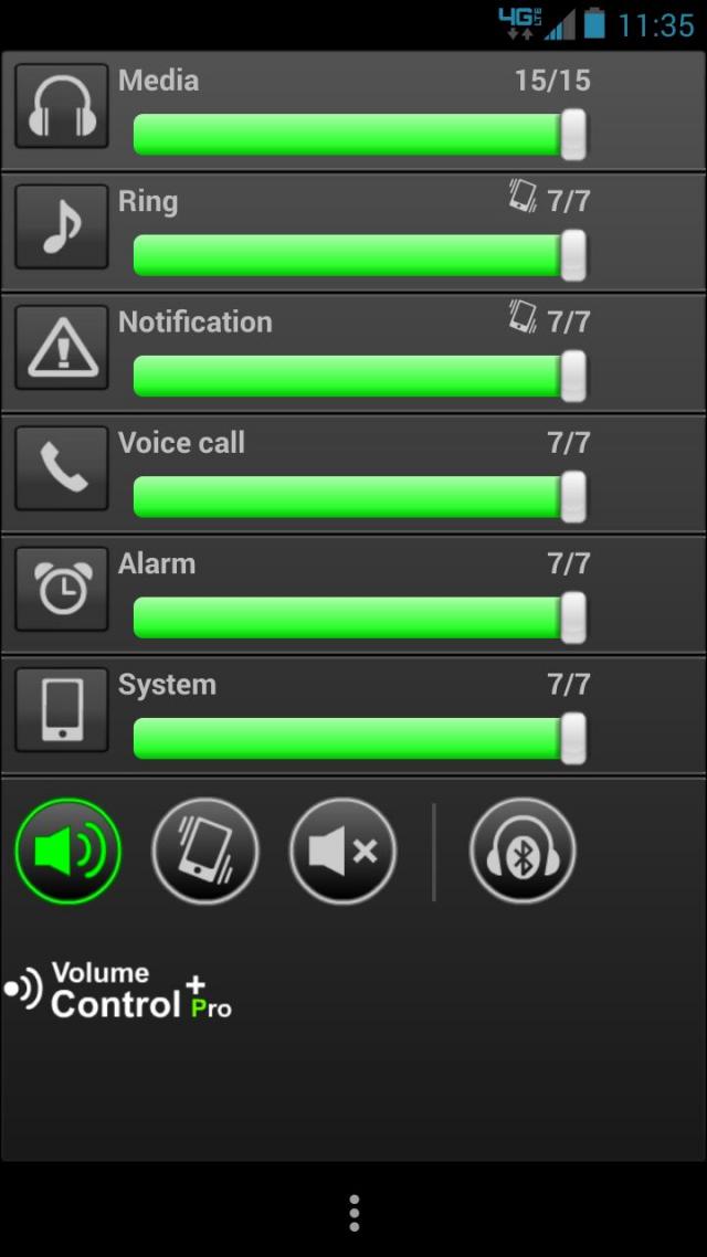

I always found volume controls to be one of the most confusing aspects of Android until I found ... Volume Control + Pro (there is also a free version). I have used it for years.
The display shown below is extremely useful in seeing what is going on.
You could give it a try and see if it points you in the right direction.

Thanks, I tried that but it doesn't have a separate maps volume that I could find.
