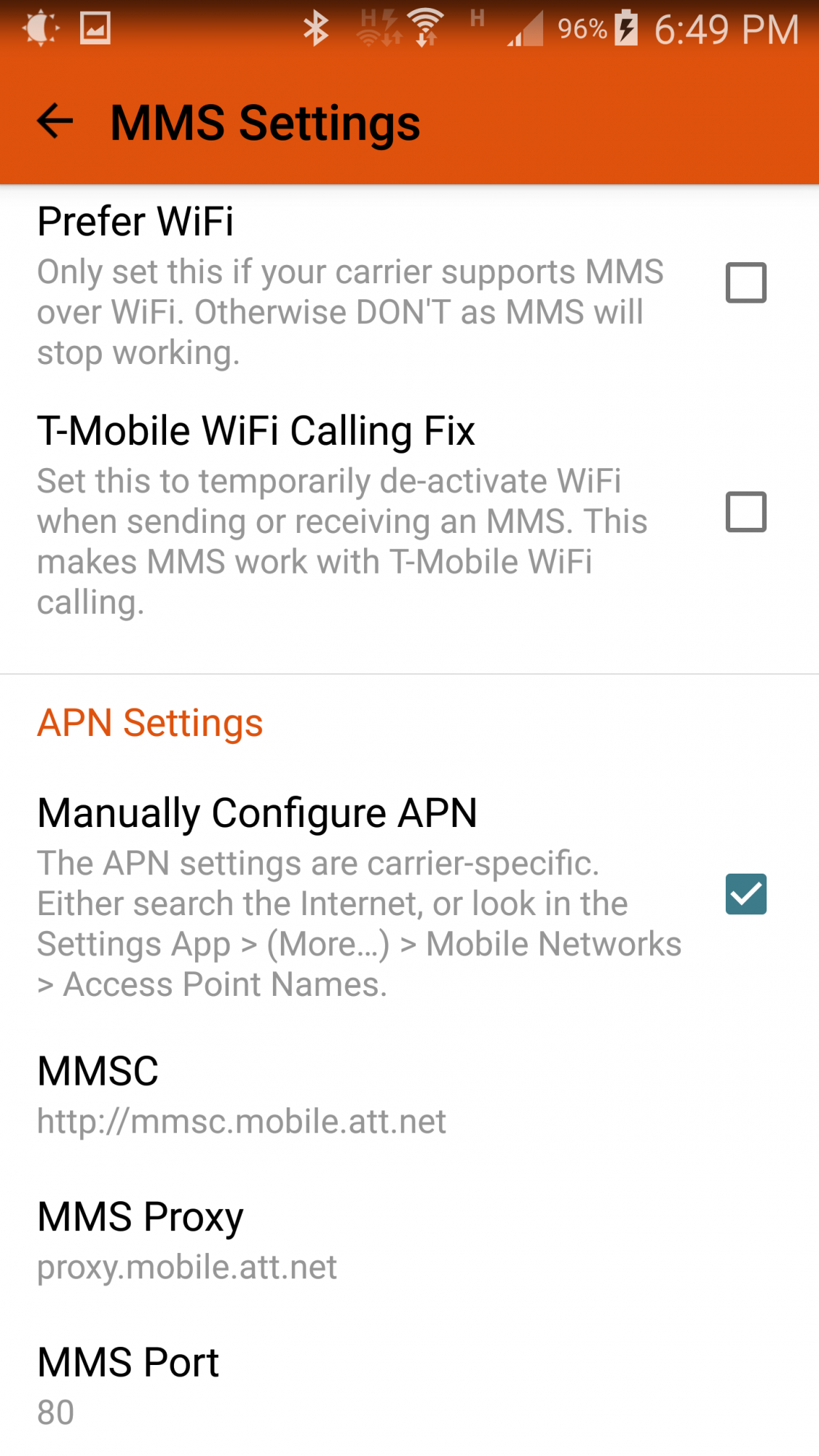

I have tried Textra, Message +, GoPro and now Chomp and I really like Chomp but it just wont send a photo. Keeps saying Sending. Don't know if APN or whatever settings one needs is correct. Thanks
I agree that there is something wrong but what. I don't know what to do with the settings on the phone to solve this problem thats why I am reaching out to you guys. These are the phone settings.
Change the size limit to 1MB & Check the WI-FI Calling fix box.
If the above works,try increasing the limit size until it doesn't work anymore,then set back to the last size that works.
You might have to manually set the APN,especially if the phone you're using is originally meant to work primarily on a specific network (A VZW phone on AT&T,for example).
Do I need to get att to fix it or is there a way to fix it myself. With the help of you guys of course.

Use this as a guide,but,use the following AT&T APN Settings in place of the one in the video:
http://www.att.com/esupport/article.html#!/wireless/KB424489?source=redirect
The following needs to be exact,case sensitive,or,it will not work.
Make sure you actually select the APN once you have it programmed into your phone.
APN: phone
Proxy: Not set
Port: Not set
Username: Not set
Password: Not set
Server: Not set
MMSC: http://mmsc.mobile.att.net
MMS proxy: proxy.mobile.att.net
MMS port: 80
MCC: 310
MNC: 410
Authentication Type: None
APN Type: default,mms,supl,hipri
APN Protocol:IPv4
Bearer:Unspecified

As you can see I need the mobile virtual operator type in order to turn APN on.
