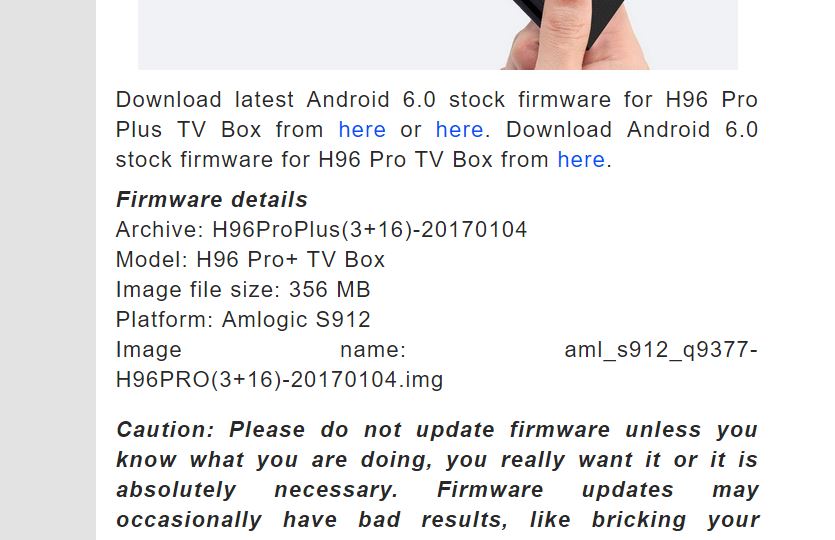

Speaking of....I've found a site punting an img file that allows for upgrade (see attached screengrab) but with no howto instructions (i assume they assume i know what I'm doing). any opinions?
I couldn't say for sure, upgrade instructions for devices differ greatly. Sometimes, you can just put the img file on the SD Card and it will be picked up on boot. I wouldn't feel confident saying that's what needs done here though.
Did the box come with instructions? Do they mention anything about recovery mode?
