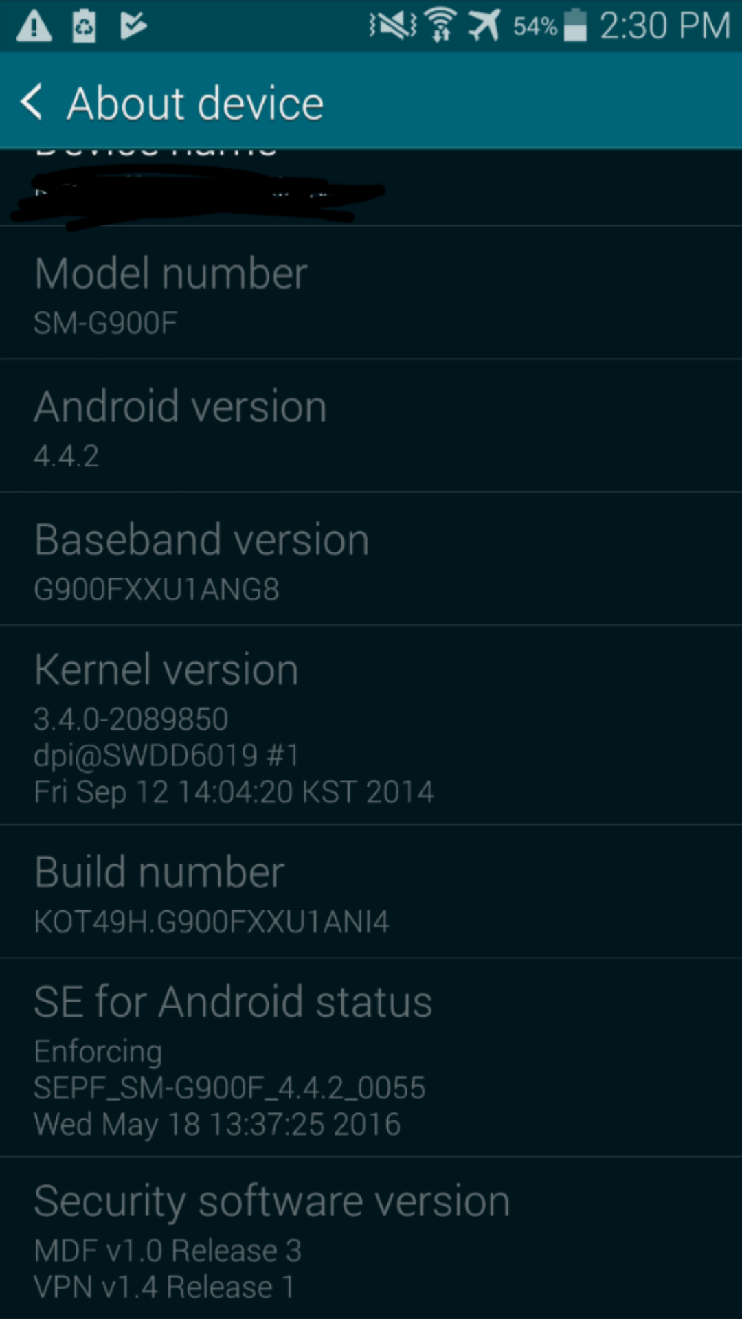

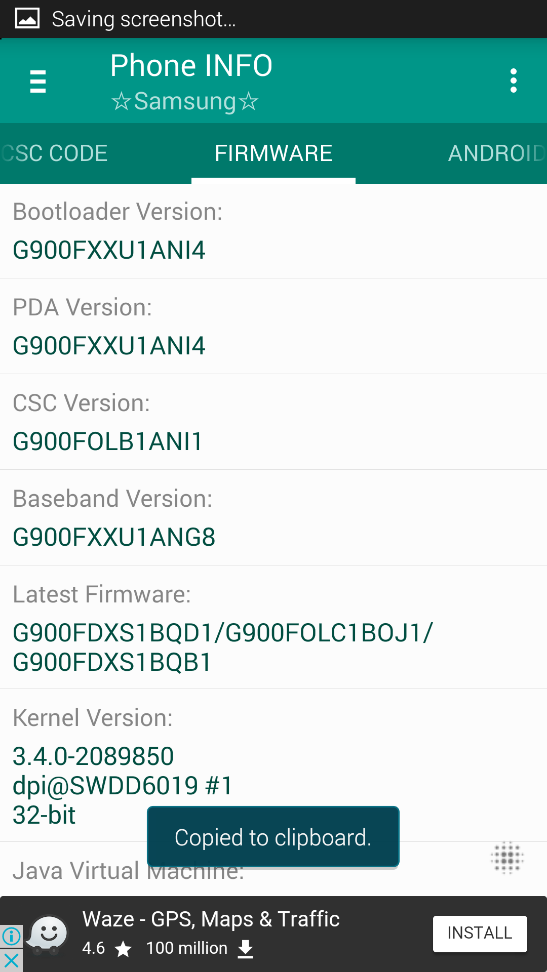

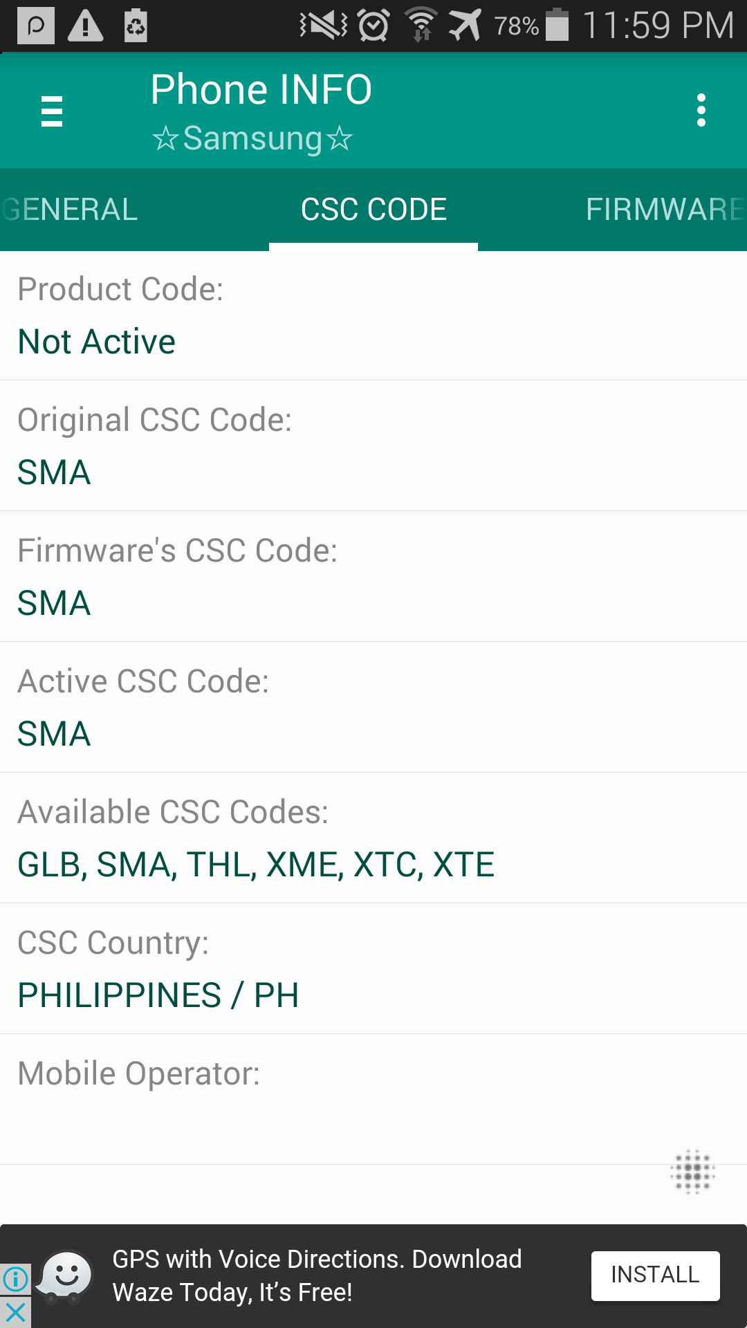

Need help in unrooting my s5
My s5 is openline but it was Smart locked at first (Philippine telco). Since it is rooted and and i want to get updates. What firmware will i download (refer to photo below). When It will be finished flashing, will it be still openline and not smartlocked? Thanks btw please help.

What firmware would I use to get into marshmallow (referring to the site cause there is no marshamallow on my device), can I directly go to marshmallow?
International versions of Samsung devices always give me the hardest time.
You usually have to flash a firmware that matches your CSC codes but I have seen where others have flashed firmware for other countries and not have a problem except no OTA updates.
Samsung devices are normally forgiving if you try and flash the wrong firmware and it will just fail in Odin and reboot into the old system or you have to flash the correct firmware to fix it.
