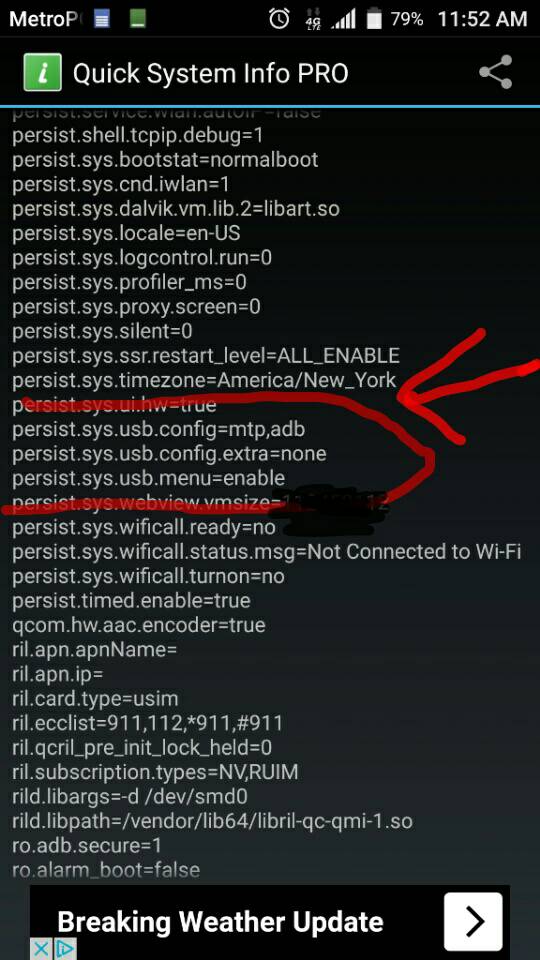

Try getting an ifo. App and check if you guys have the driver installed; framework u guys can download a compatible hml, hdmi framework.apk n push iy plus you guys need to tweak your persist.sys.(properties) so it can function. Now know you I'M NOT RESPONSIBLE FOR SH'€π. YOU CAN DAMAGE YOU DEVICES IF DON'T KNOW WHAT YOU'RE DOING.
