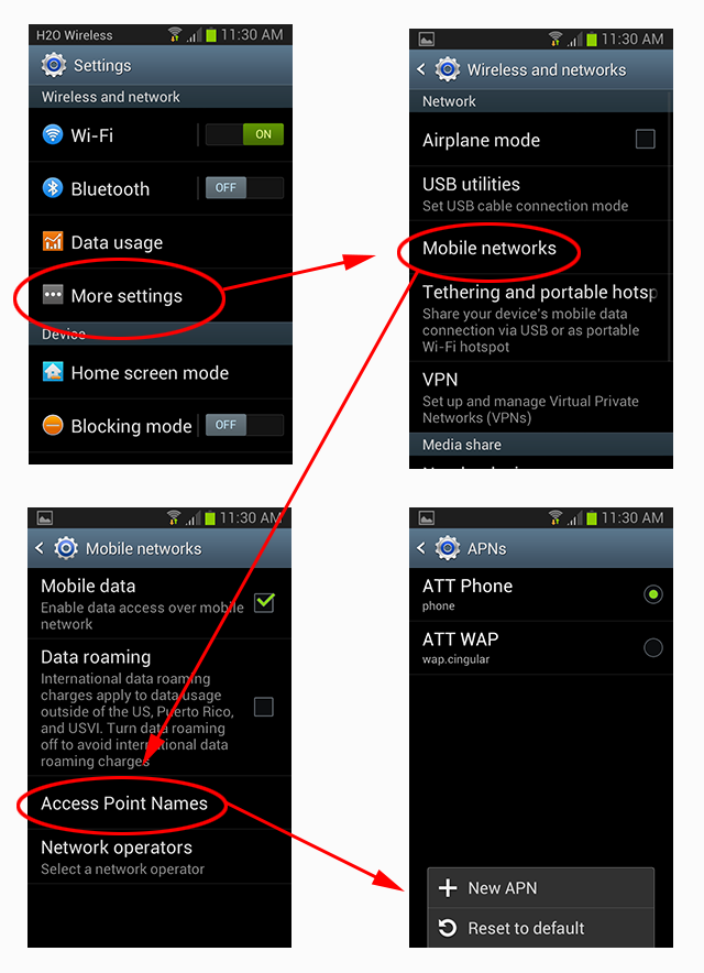

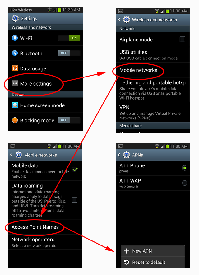

Are you sure it's not there? I've just checked four different phones (Nexus 6, S7 Edge, Nexus 4 and an old S2) and it's always listed right under cellular networks. Could it be you need to scroll the screen to see the Access Point Name Options? Sorry, I don't have a phone running Cyanogen to be able to check.
If you don't see something like this then let us know exactly what you see under cellular networks.
