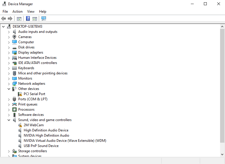

Ok tried Odin 3.13, 3.12, 3.10, and 3.09. But nothing same thing, nothing shows up, but I did forget to say this, when I go in device manager it seems that Windows does not recognize the device either, I'll post a photo

I don't use Windows, However I'm a bit familiar with Samsung devices. It showing "PCI serial port" as an unrecognised device, is not good. From what I've seen previously, that means the tablet's firmware has been completely trashed, i.e. bricked, could be by whatever rooting you did previously. Odin can't fix that. AFAIK it would need to be re-flashed using the manufacturer JTAG rig, which is what Samsung would use during production in the factory. And unless you got one of those, it's new tablet time, that's it.
