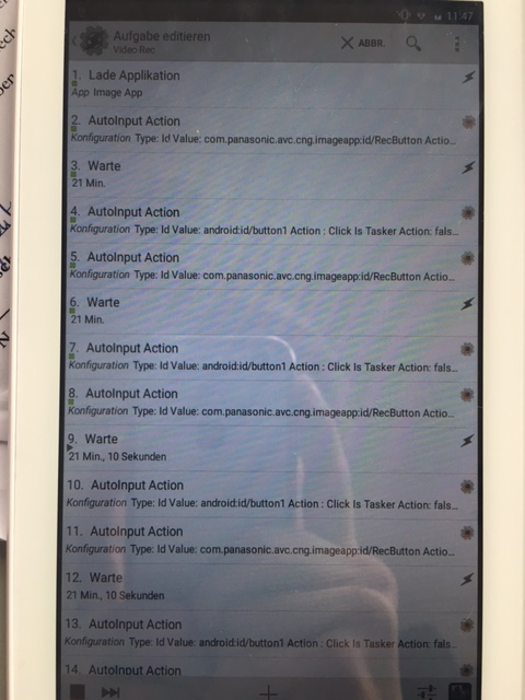

Hello Sumotori thank you for your answer! No i don't have root access till now. I bough AutoInput already and it works very fine for pressing this button. The problem is that i created a wait variable for 21 minutes but the error message doesn't pop up after exactly 21 minutes. I want Tasker to check when the error message pop up and click it and start the next step
i attached a pic of what i did till now.. sorry, real screenshot was not possible because the pad is connected to the camera over wifi. I need this task for bypassing a camera recording limit

Programming-wise I'd suggest a different approach, where instead of waiting 21 minutes, you wait until the message pops-up, i.e. "Wait Until %Error_Message ~ True". To do this, as you said, you need Tasker to know when the error pos-up and set the variable "%Error_Message" to true, where by default is false.
What type of pop-up message is that? Does it also go with a notification?
I am not very familiar with notification/toast interception. Some apps exist such as AutoNotification and Notification Listener. The second can be used for the part you want for free I think. (Make sure they work for what you want before purchasing any)
Random comment, I prefer to split tasks to smaller sections, and then use variables and profiles to trigger them, as opposed to a single task for all actions.

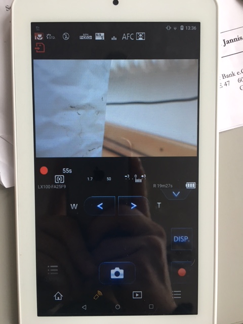

The Problem is, that the error is not connected with a notification. It's a Error in this Panasonic App, which says something like "Wifi Connection" interrupted or "Recording Time Limit reached" or maybe "SD Card Full" and there is a Ok button under it
Do you think that tasker can "listen" or check the middle of the screen till this pop up with the ok button shows up?
here you see a picture how the app looks and the error of panasonic pops up in the middle.
I just found out that it's possible to get the XY Position with the Easy Step Function of Auto Input so i know how to locate the Ok button. But i just need help to set up the parameters, so tasker waits till this field is "ready to touch"

Can you post a picture when the error message has popped up?
I am thinking that you can create a profile that monitors for this Pop Up, similar to Taskers State > UI > Notification/New Window.
So if you can specify the Window label and type, this could be your trigger?
You also have AutoInput checking if an element is present via UI query?
