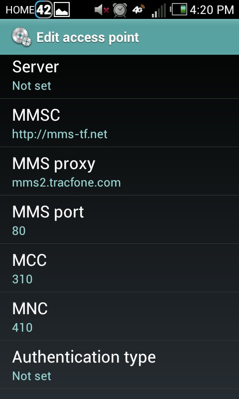

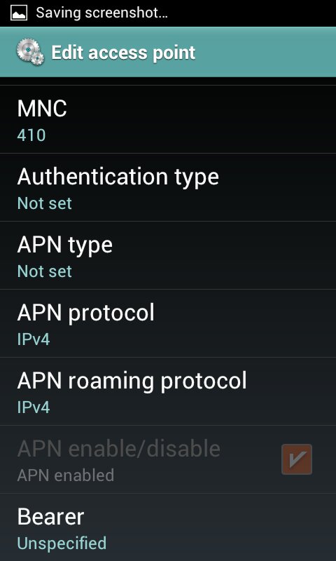

I've spent a ton of time trying to get everything working on my pantech burst and my wife's Samsung galaxy s3. Finally I have found the sweet sweet sweet spot to where everything works! And now I am here to share them with y'all in hopes I at least save 1 person time and headaches.
The photos attached are direct screenshots of my Pantech Burst. Everything works perfect. Now here are main bit of info written down:
APN NAME: NET10
APN: tfdata
MMSC: http://mms-tf.net
MMS PROXY: mms2.tracfone.com
MMS PORT: 80
MCC: 310
MNC: 410
That's what works for my Burst and my wife's S3. Good luck and I really hope this helps everyone!
