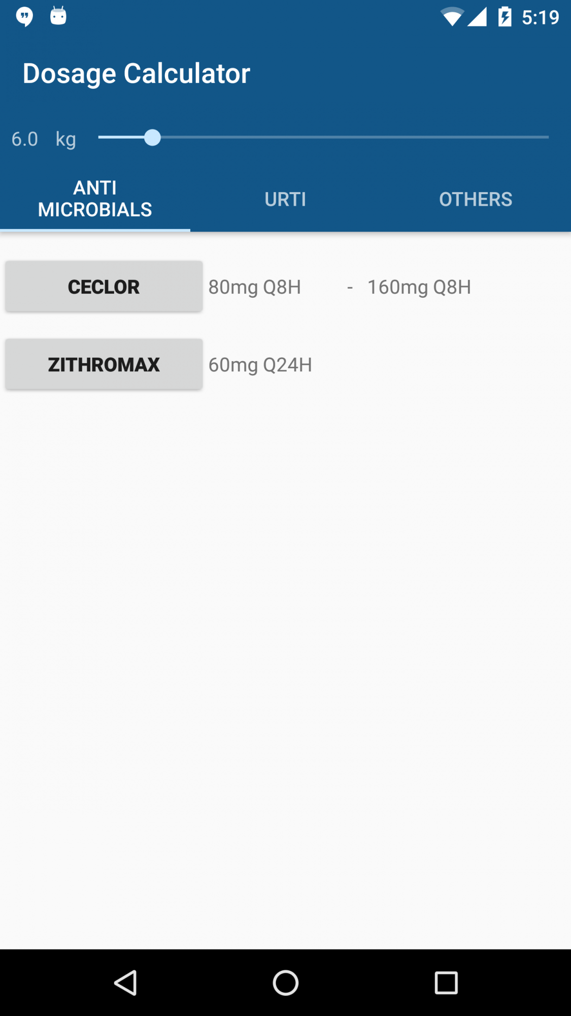

the idea of the app is that there is a Seekbar on top for user to adjust the body weight
so that all the drug will spontaneously show the calculated dosage.
I have a successful attempt when making the first trial using one MainActivity and one XML file (referring to the pic success_trial.jpg)
However, when I do my second attempt to make a Tab Layout with Swipeable Views, the app force closed once I touch the Seekbar.(referring to the pic failed_trial.png)
