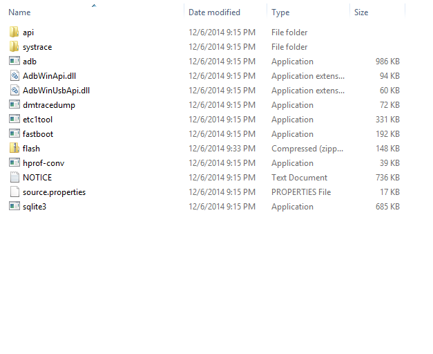

-Put your phone in fastboot.
-Open cmd (in PC) and type in your plate-form tools directory or use AF mini sdk tools (http://androidforums.com/threads/adb-guide-updated-2014-11-11.443072/) click the "MINI-SDK" link
(Don't close your cmd prompt throughout the process)
-Plug in your phone via usb and have your cmd already set under the directory of the adb stuff (see attachment)
-Type "fastboot devices" and see if your device is seen by the pc via usb connection
-If you see it, type "fastboot oem format"
-If that doesn't work do
fastboot format system
fastboot format data (THIS WILL ERASE SD CARD)
fastboot format cache
-If all goes well, boot to your recovery and flip it on to sideload mode
-In cmd type adb devices and you will see your device's S/N
-Move your ROM and GAPPS that you want to use inside the folder of adb stuff and rename them "cm" for rom and "gapps" for your gapps
-Type "adb sideload cm.zip" if successful proceed sideloading gapps "adb sideload gapps.zip"
-Try and boot into rom...
If your getting error closed messages, try and reinstall the google driver. Wug fresh toolkit has a great driver install guide that ensures a clean install of the driver.

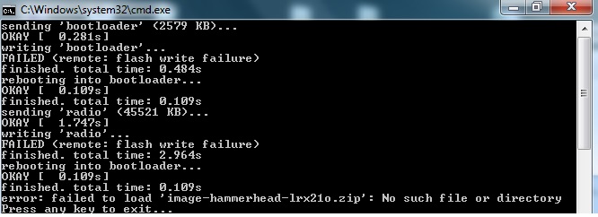

In Dos mode "failed (write memory failed)"
System data , user data all are show me Failed..
please other...option
Can you update your twrp recovery? 2.8.3.0
These posts keep pointing to having a corrupted emmc. XDA has some guides for corrupted portitions but it may touch on emmc problems as well.
