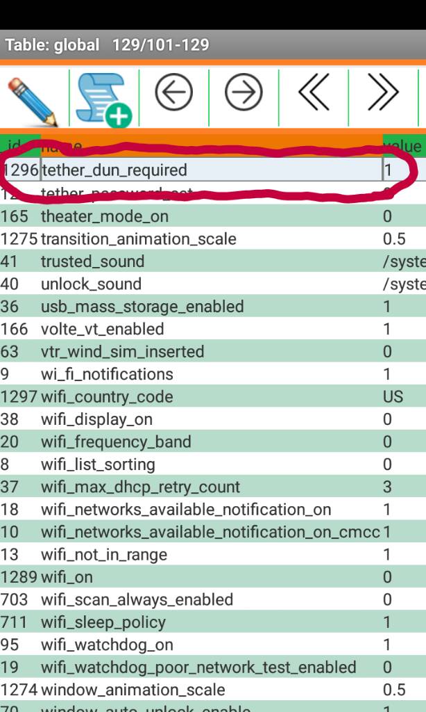

A- Serach for tether_dun_required
* Tap on it ... in the pencil on top right click on it..
** Change Value from (1-one ) to (0-cero ) SAVE and CLOSE

This can be fixed permanently using the following procedure (UPDATE: no root required):
  1. Enable developer mode (Go to Settings -> About phone, and click on the build number until the developer mode is enabled).
  2. Enable USB debugging under Settings -> Developer options
  3. Connect the device with a USB cable to a computer with the Android SDK platform tools installed
  4. Start an adb shell: adb shell
  5. In the adb shell, run this command: settings put global tether_dun_required 0
Would this method work?
Yes it will
Ok, if it is for a fact "DUN" what's causing hotspot not to work with LTE on MetroPCS. How come Hotspot works with LTE on T-Mobile network? I have another phone with unlimited T-Mobile $80. I swapped the sim the other day and it works fine.
Its not the network (provider) its the actual ph it self... You need to be able to change (tweak) ur device... By adding apn & tweaking build.prop
Those instructions i gave u were tested on NX5 and 6 for me. And it works but you most be rooted.
