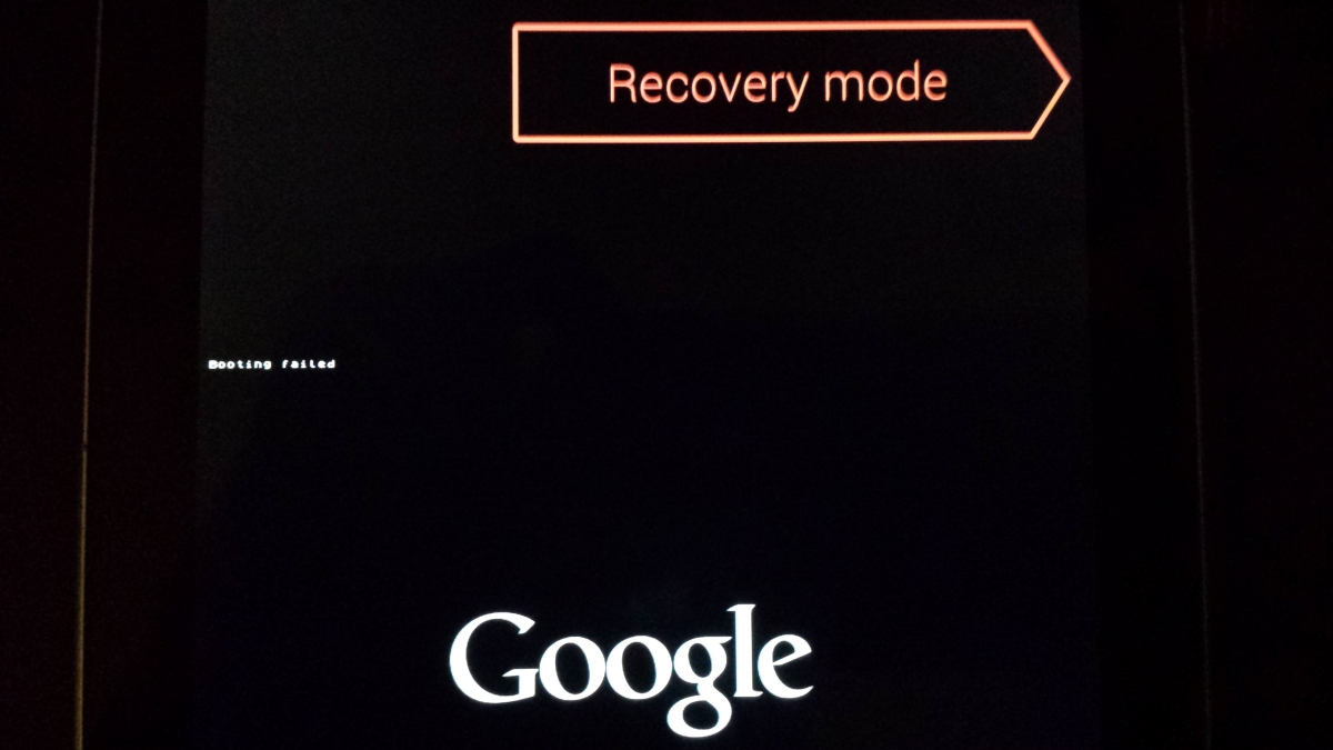

My nexus is stuck on Google screen when I turn it on. Can't get into the O.S.
When I try to do a hard reset by pressing the "up and down volume keys and the on button", the options available will say booting failed. Cant plug it in the computer with the device to show on my PC to retrieve files cause it wont turn on. Anyone know a fix?

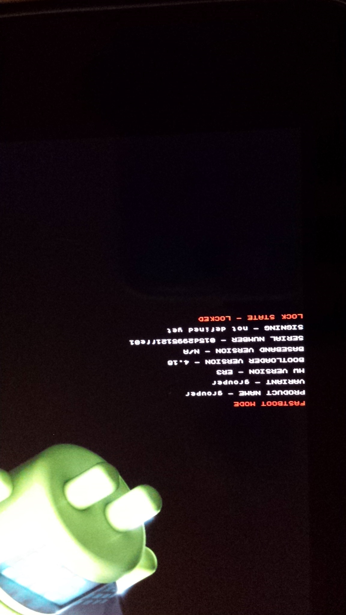

I didn't do any changes into the OS since i purchased it so not rooted and its stock. I am not very familiar with ADB. I have attached a new pic on what the screen says at the bottom left. It says lock state - locked so im assuming bootloader is locked

Yep, indeed. So you've tried booting into recovery and it failed with the same boot error, correct?
If that is the case, then the only option to fix this is going to be to unlock the bootloader because we can't flash anything while it's locked. However doing so will result in a complete data wipe of the device. There really isn't a way around it.
To do everything, you're going to have to hook it up to a computer. You'll want to configure drivers, unlock the bootloader, and then flash the factory image. This can be done one of two ways. If you have Windows, there is a toolkit called Wug's Nexus Toolkit that makes most of it pretty hands free. However if you have a Mac, it will have to be done manually from the command line terminal.
